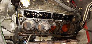

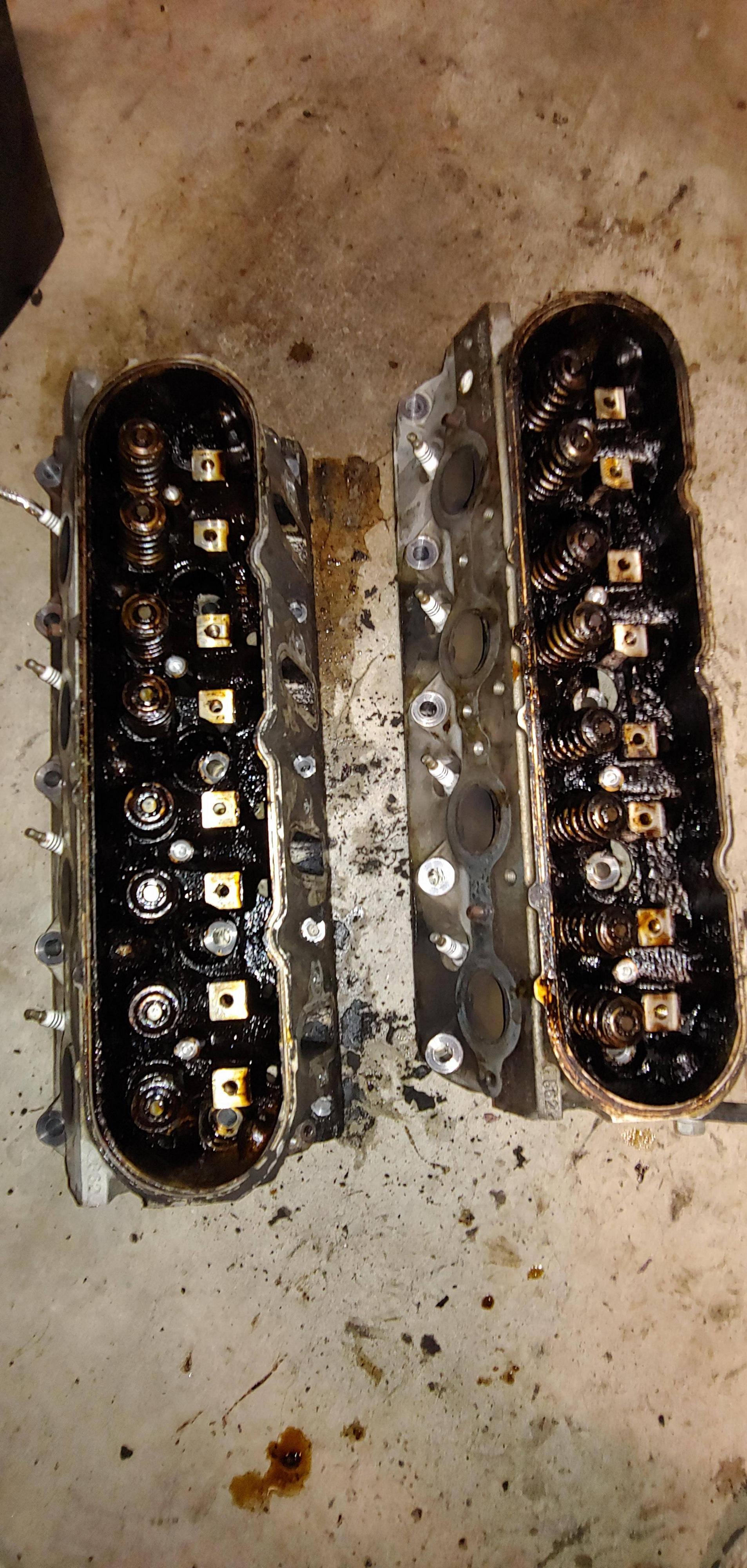

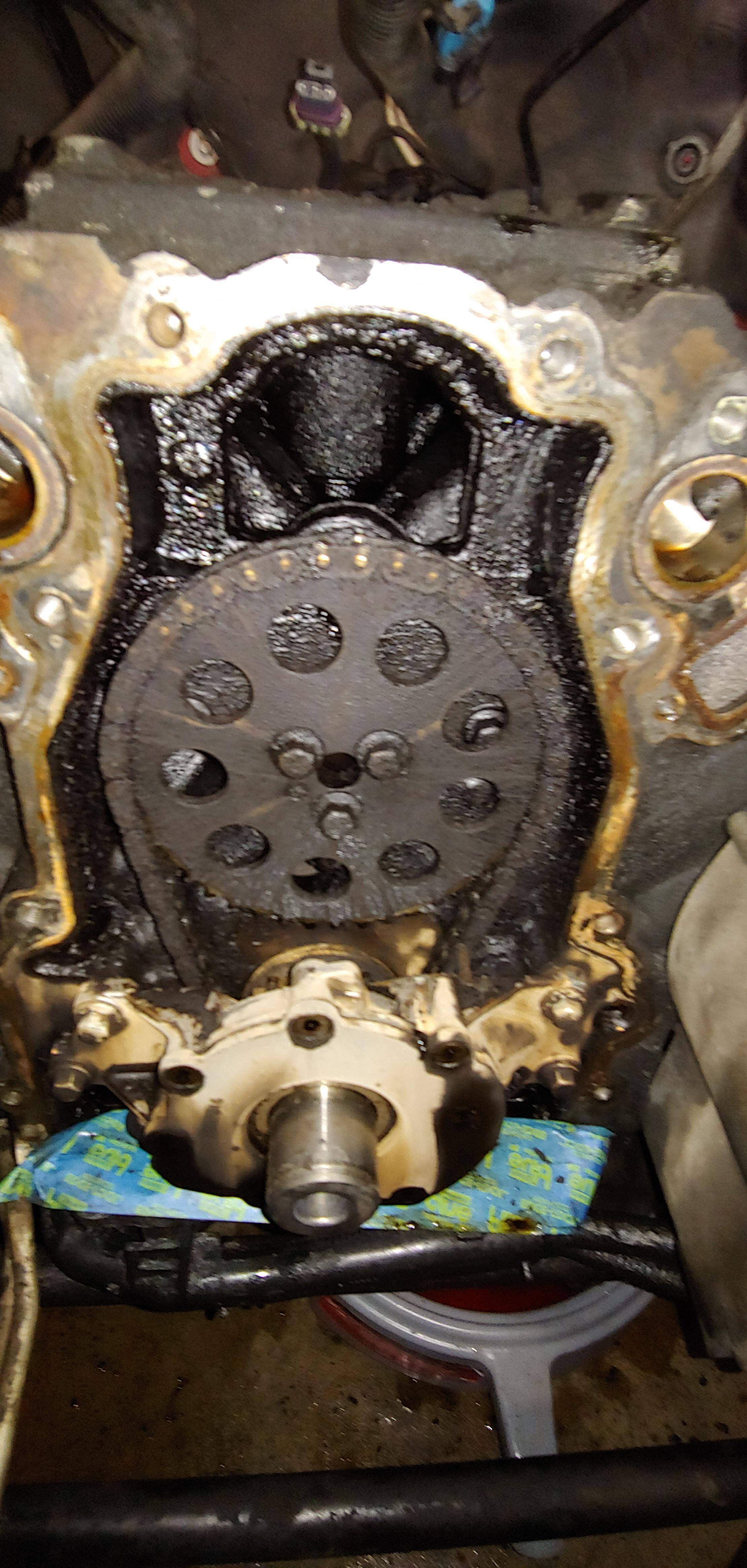

Long story, Ill make it as short as I can. I bought an '04 Tahoe 4x4 w/ the 5.3, 155k mi about 13mo ago - completely stock. Once I changed the oil a few times a pretty bad lifter tap appeared on cold starts, got worse pretty quickly. This gave me an excuse to rebuild the top end, and add a new cam/heads at about 172k mi. Over the 4th of July weekend I tore it down to replace the lifters w/ new LS7s, pushrods, BTR stage II cam, built 243 heads, all gaskets/hardware in between, and a dyno tune afterwards. I was a GM tech for 5 years and have done a few performance head/cam swaps on these engines in the past, so its a job I was very familiar with. Everything went pretty well until I got the front cover and valve covers off. This engine is hard sludged worse than almost any engine I've ever personally worked on. Looks like between the fuel dilution, probable long oil change intervals, an obvious overheat or two, and maybe some water entry from the previous owner, this bulletproof engine is in alot of trouble. I pushed on with the rebuild, cleaning everything as well as I could without a parts washer. Here are some pics pre-cleaning:

I double checked everything, put it all back together, and went for the initial engine startup. Got 0psi oil pressure after about 15sec, shut if off - crap, I guess the oil pickup tube fell off while I was manually turning the engine over or something? Whatever, time for a new pump and LS2 chain/sprocket I guess. I didn't have room to drop the diff and pan in my garage, and was short on time, so I had it towed to a shop close by. They found that the oil pan had about 1.25" of black sludge built up in the bottom of the pan, so between that and anything I may have dislodged during the job the oil pickup tube had clogged up completely - this got me worried because I know some had to get into the pump, but didn't think it would cause a massive issue. They installed the new pump, tube, and timing chain/sprocket, double checked all of my work and saw no other issues that would cause low pressure. When they started it, they only got 4psi oil pressure at idle. They cleaned out the oil pressure sensor, checked it with a mechanical gauge - still 4psi. At this point the mechanic and I assume sludge got moved through the system and probably clogged atleast one crank bearing or some other oil passage. I had him flush the hell out of it twice, once over the weekend - still 4psi on Monday morning.

looks like coolant contamination in the oil, imo

The oil cross over in the rear cove may be so clogged its preventing oil to the lifters and preventing drain back to the pan through the passenger side of the lifter valley, so thats something to check
could pop the pan off and pull rod caps and look for sludge in the crank as well
