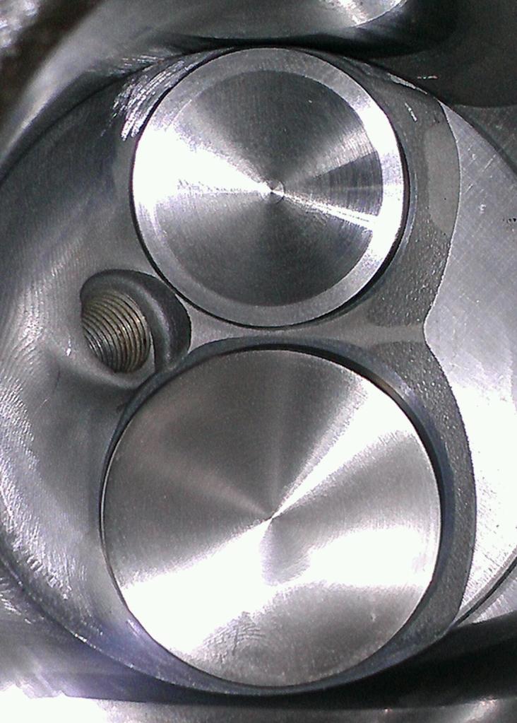

I was just talking to a couple people today about going with worked heads and using too large of a valve. I think those heads would work very well with a stock bored 4.8/5.3. Just for the record, this is what a 2.02/1.57 valve looks like in a stock 4.8/5.3 bore. I think I went too large when I did my 5.3, but they look very good in my 6.0 cylinders.

Awesome! What else would be different from my stock heads? The valves? I wanna turn my boost up without having a problem with valve float.
