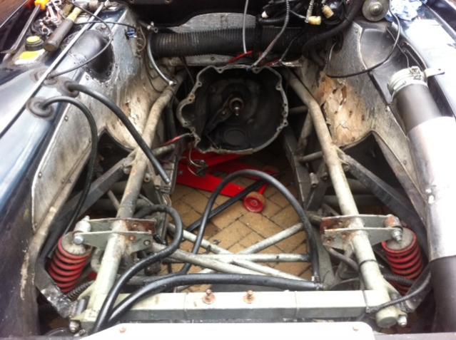

I got a TR6060 for it
Just trying to decide on a clutch at the moment
Here is where It will be going
Attached Thumbnails Shopping list for 5.3 L33 7-7.5k rpm's-empty-bay.jpg   Shopping list for 5.3 L33 7-7.5k rpm's-65829_10150306250880393_579330392_15344397_244720_n.jpg
