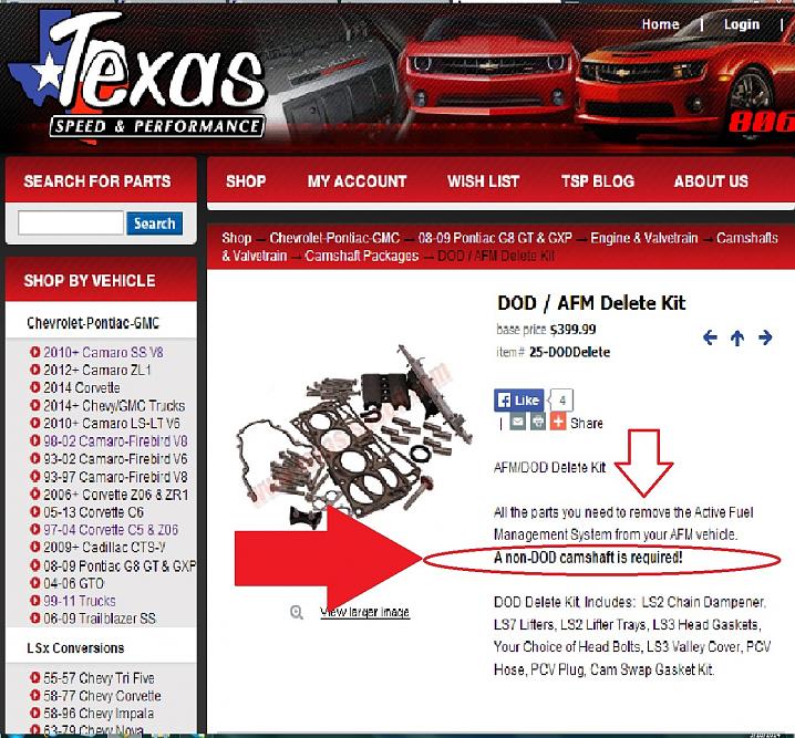

Originally Posted by Sales2@Texas-speed
I understand you don't want to believe us at this point, but step back and look at how it all works. Cranking compression requires good rings and valves that are closed. Obviously this swap changes lifters and valley cover which before would affect the valves opening/not opening under light load cruising speeds. Now, you got rid of all that. The cam lobes are in the same position before the swap as they are after you change a cam, they just have different duration, lift, etc.
So we know your rings are good enough to build and hold compression, obviously. What could possibly hold the valves open on that setup?? The answer is too much preload (bottoming out the plunger). That could be improper pushrod length, or improper install/torque on the rocker arms. That is physically all that can cause the issue. It's not a stock cam problem. I am sorry it is this way, and I know you want to have confidence in your installing shop, but they are wrong.
I am very Confident in my installation skills. Glad you decided to see things my way.
