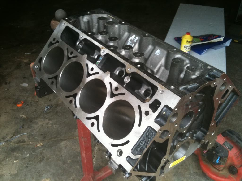

5.3L
6.0L
I can definitely see the bore difference between the 2 blocks especially between the cylinders
