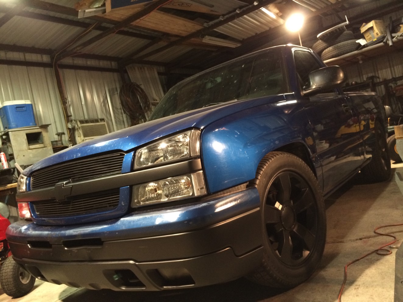

Its going in a NBS 2003 Silverado RCSB

Nice truck man!! Really like the drop on it. That 5.3 should really get that thing moving though!
