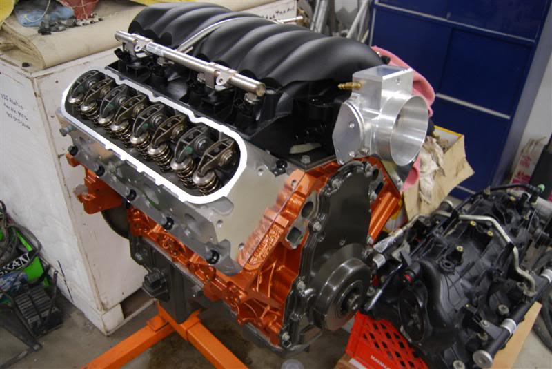

Latest pics, I just test set/fit the intake on there to see how it would look and dang!!!

What water pump are you running? What are you doing about belt alignment? Spacing water pump? Swapping w/p pulleys? Relocating idler etc...
I'm going to be running the complete front setup off of a corvette (It's already on the 5.3l). Brackets, Water pump, power steering, alternator, idler, crank pulley, and gaterback belt.
