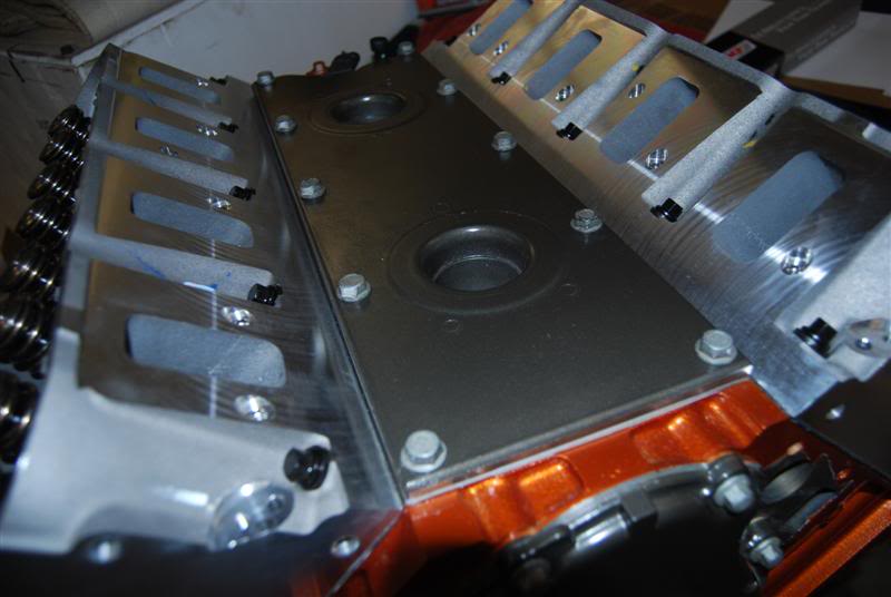

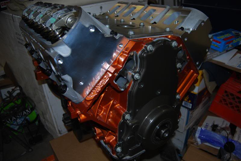

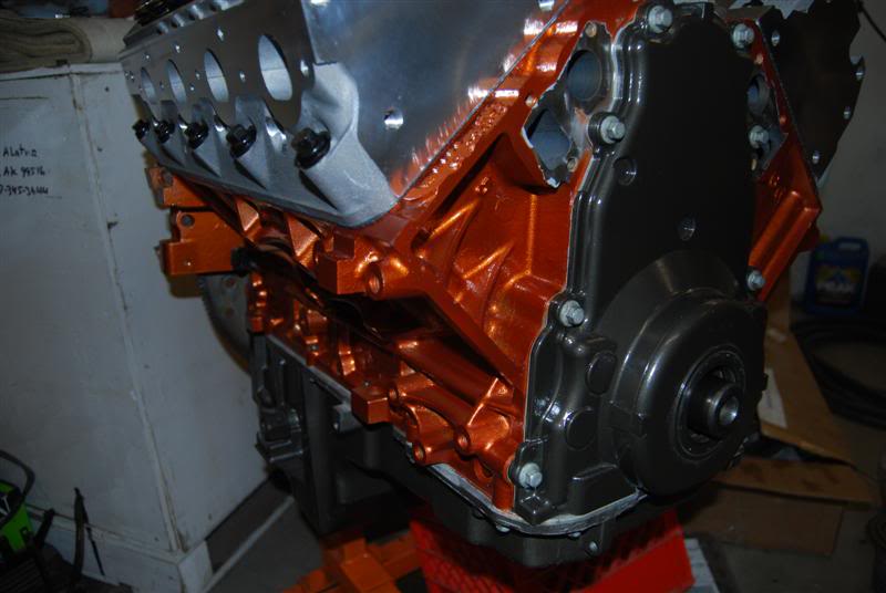

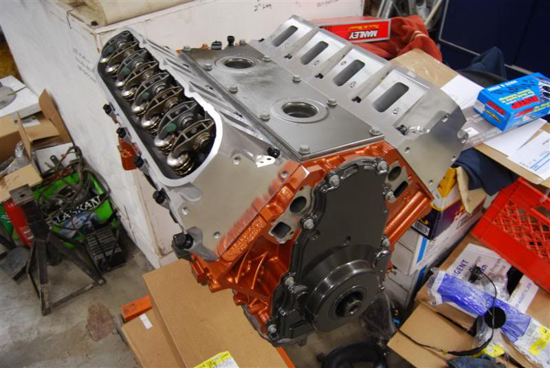

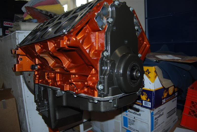

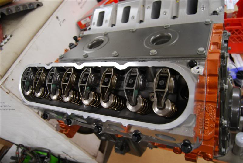

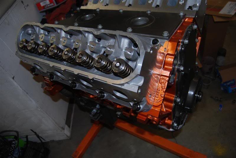

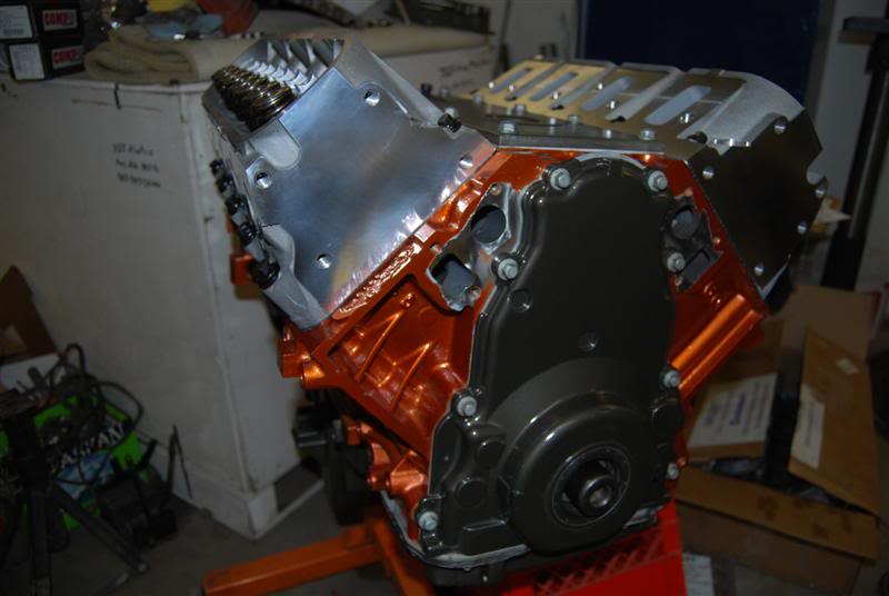

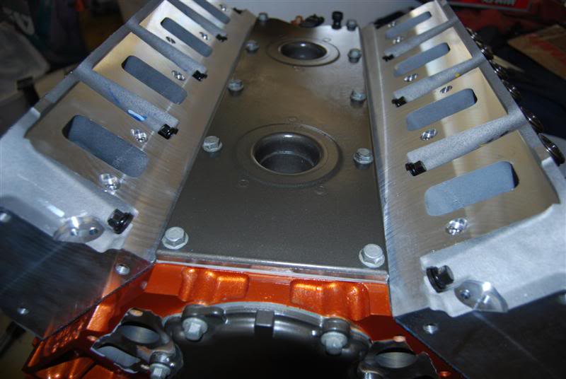

Installed the New awesome L92/LS3 heads, bolted them on with the new ARP fasteners and Felpro gaskets. They definitely set off the copperhead block and the nice gray colored aluminum parts I painted with High temp engine paint and high temp clear coat.

Dang! That'll be one sweet setup. Just makes me want to start from scratch and re-do my swap again. Maybe I will...

That should run pretty good.I like it.Well done

Got all the valvetrain installed into the heads, had a problem with one of the rocker arm bolts somehow it got stripped out even though the heads where new. I tried to tap it out reinstalled the bolt and tried to torque it but as soon as I tried to tighten it the threads pulled out of the head. So I had to helicoil it, but it all worked out and now its all installed.
