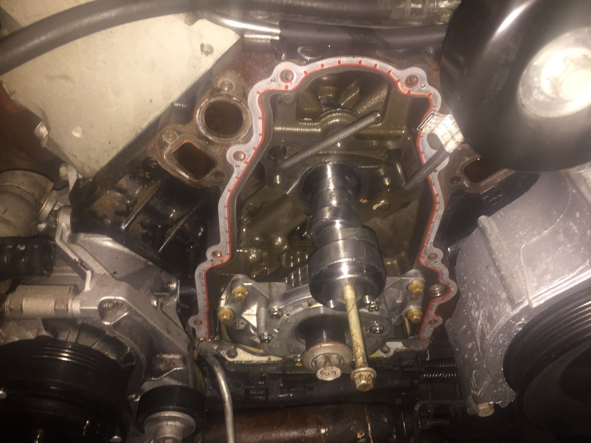

Is there a way to get the timing chain off the cam gear with the oil pump still on? Havnt looked at it yet but people are saying thats the way to do it..
Just pull the cam gear off with the chain on it. Pull the gear out and let the chain drop. When you reassemble, put the chain on the gear before bolting it back on the cam.

Unbolt the cam gear.... And wiggle it off the cam, you are going to need a heat gun or really hot hair dyer to heat the tensioner up and make it pliable so you can compress it and put a pin or small allen key in it to keep it compressed....
If you do break or crack the leaf spring you can unbolt the oil pump to replace the tensioner but you do run the risk of causing an oil pressure drop due to either shifting the pickup tube or cracking it slightly....
