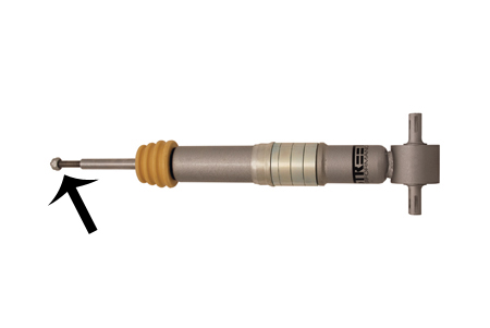

Originally Posted by Noah Burns
What is the difference in the NNBS lowering strut and the 2014?
GM made a change to the top mount. Belltech adapted to the change by giving the strut more threads to allow a safe installation.
Old Apr 22, 2014 | 04:52 PM
blownZ71's Avatar
Joined: May 2003
Posts: 275
From: Jacksonville, FL
Any lowering kits specific to the 4wd models? Something in the neighborhood of a 2-4 drop. I know there was one member who dropped is High Country but it sounds like it was parts that came from several different kits and possibly some custom fabrication. I'm looking for a 4wd specific kit that all inclusive.
Old Apr 22, 2014 | 05:02 PM
TheSuspensionSource's Avatar
FormerVendor
Joined: May 2013
Posts: 389
Belltech has NOT test fitted any 4WD models as of yet. After talking with one of their guys he believes there may be a small change in the 4WD OE spindle. But none of that is confirmed as of yet.
If the 4WD models are anything like the last generation the kit should work. You can use the 25004 strut, 6525 flip kit,6700 shackle and 2212FF rear shock. PM me for special pricing.
If it does not fit I will allow a return with no restocking fee.
Old Apr 22, 2014 | 05:30 PM
Noah Burns's Avatar
Joined: Oct 2008
Posts: 1,559
From: Fort Worth, Texas
Have what more threads? Te top mouthing bolts?
Old Apr 22, 2014 | 05:40 PM
FormerVendor
Joined: May 2013
Posts: 389
The "Stem" of the strut required more threads to accommodate the thicker strut top mount that GM used for the 14' models.
Arrow points where the threads where added
This is a strut top mount, GM increased the thickness
