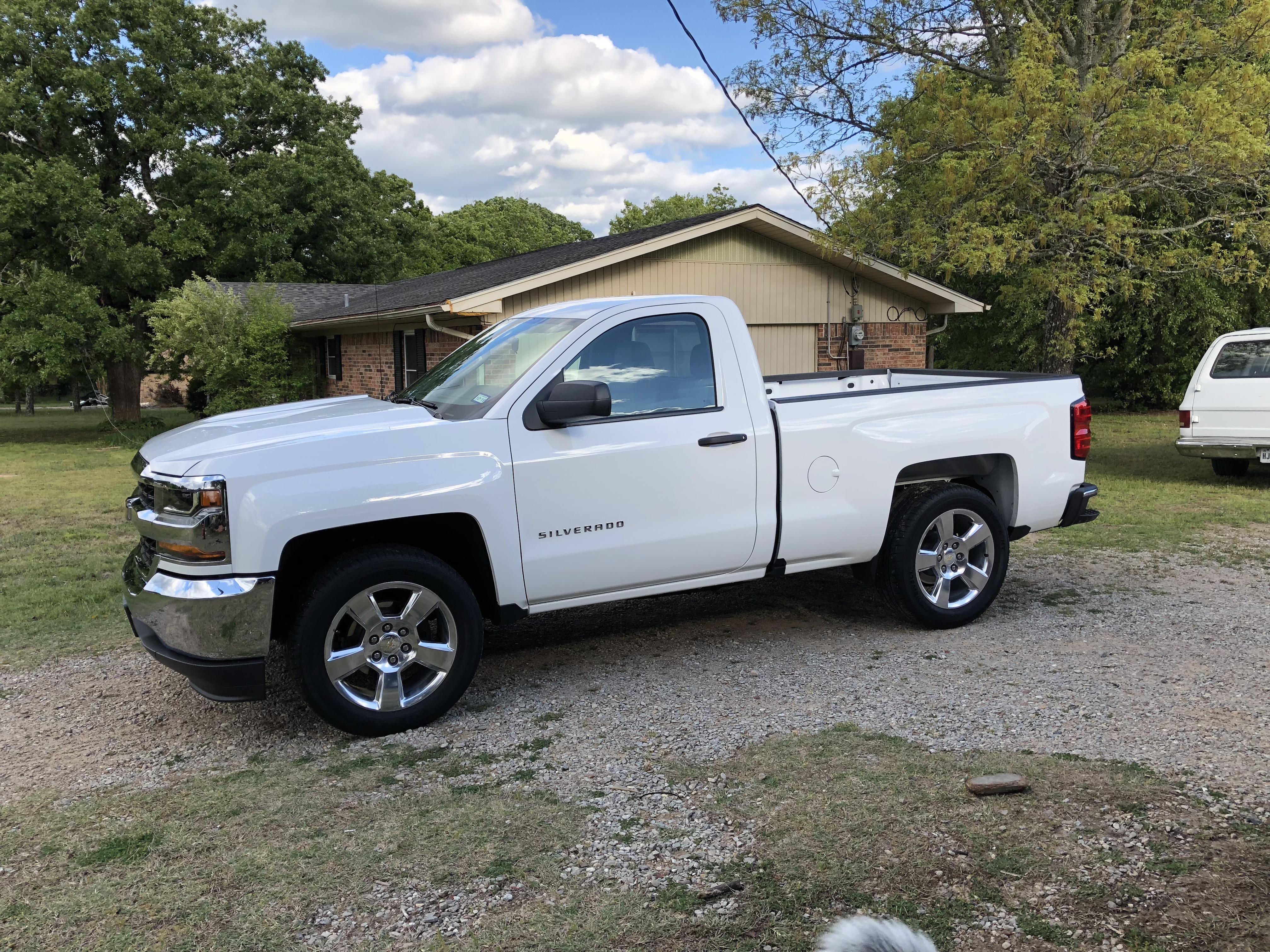

Here is a picture of mine with the bell tech rear 3 inch kit. Removed block and used the 2 inch hole. Sits almost exactly level. Have had it like that for about 2k miles (only 5300 on it now) and it drives exactly like it did before. Still want to go down 2 more in the front and rear. Have not towed anything with it so far. Happy to see yours pulled that boat fine.
Attached Thumbnails Lower leveled the truck. Pics of lift blocks removed and 1" shackle drop-ad51dec2-f381-42a2-896a-b2635bcaf7c6.jpg
