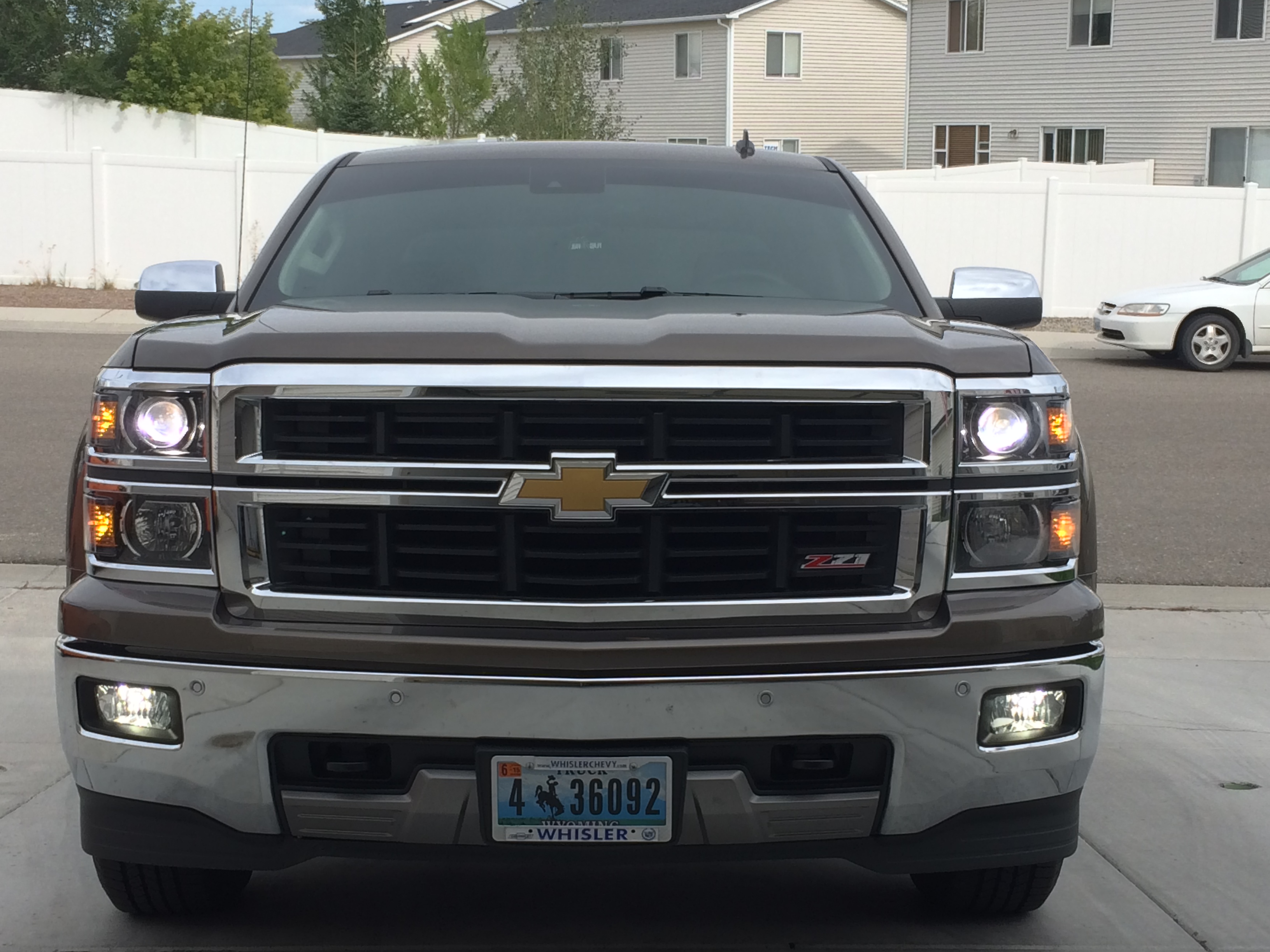

check out intensehid.com and then get the flicker relay. Thats what i did and i havent had any problems.
