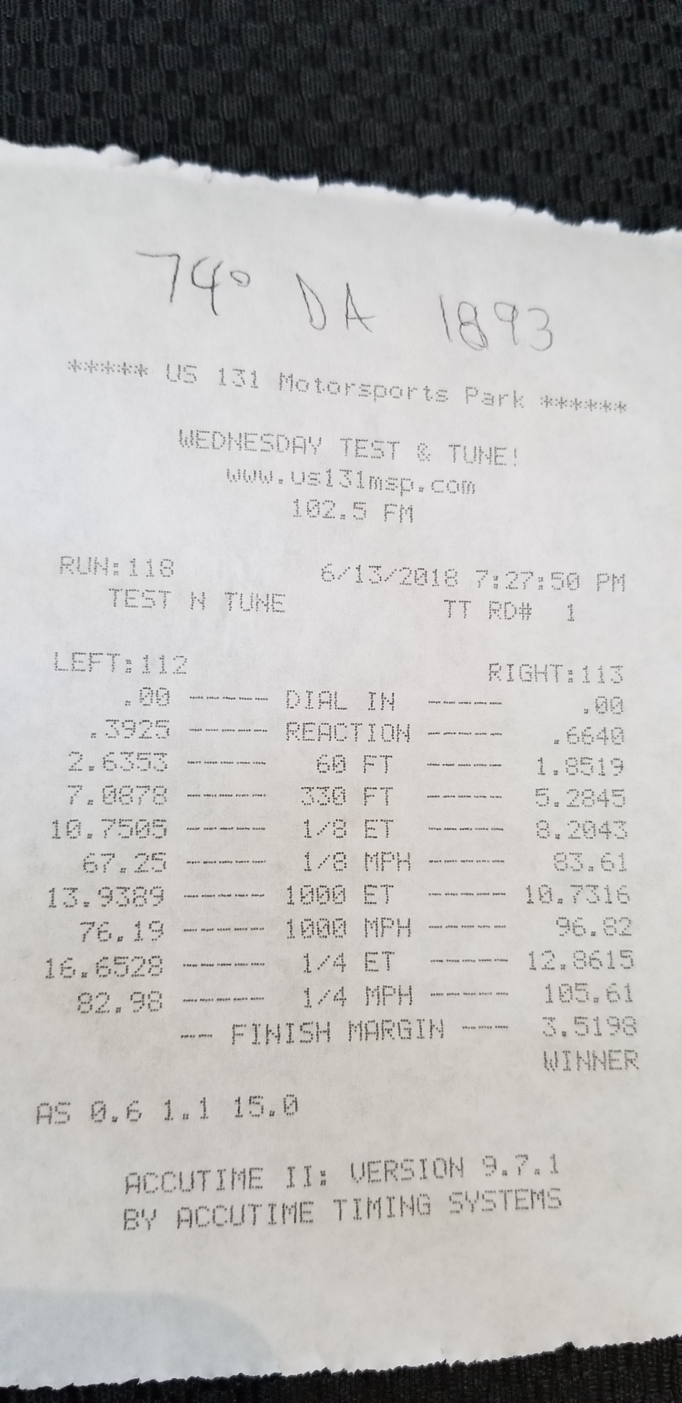

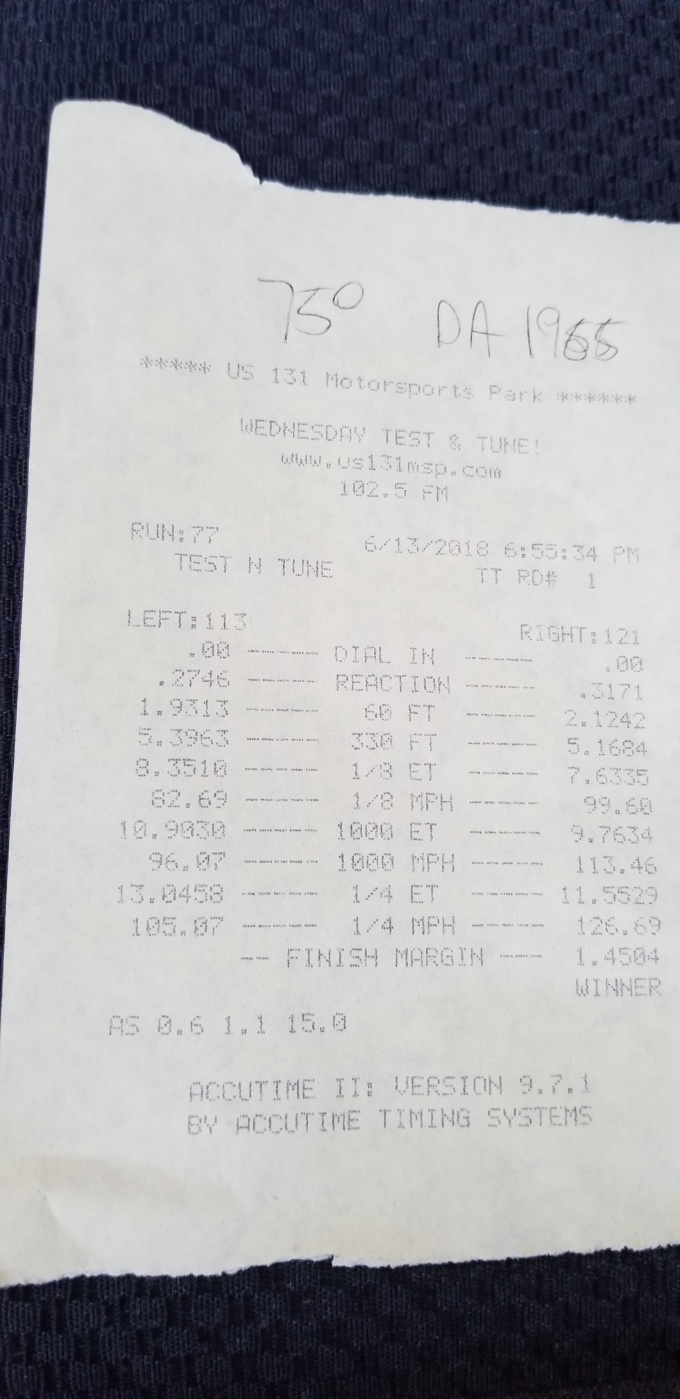

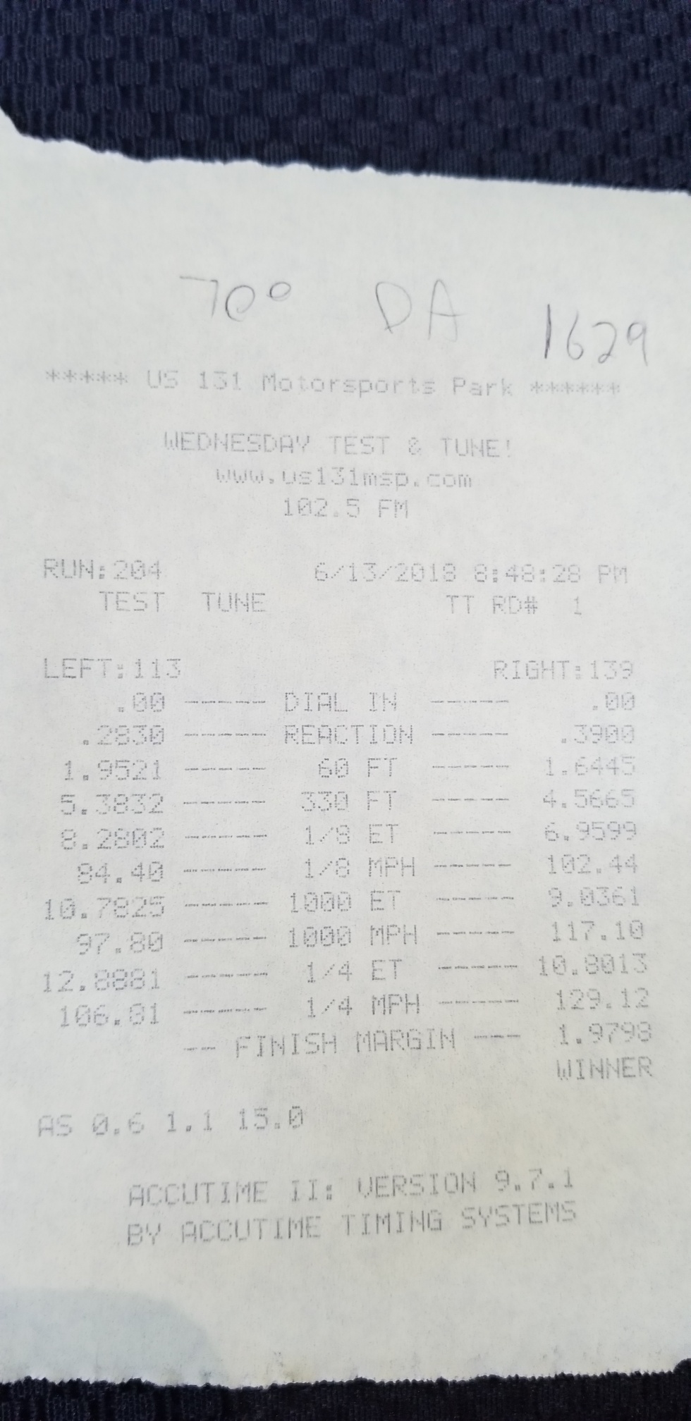

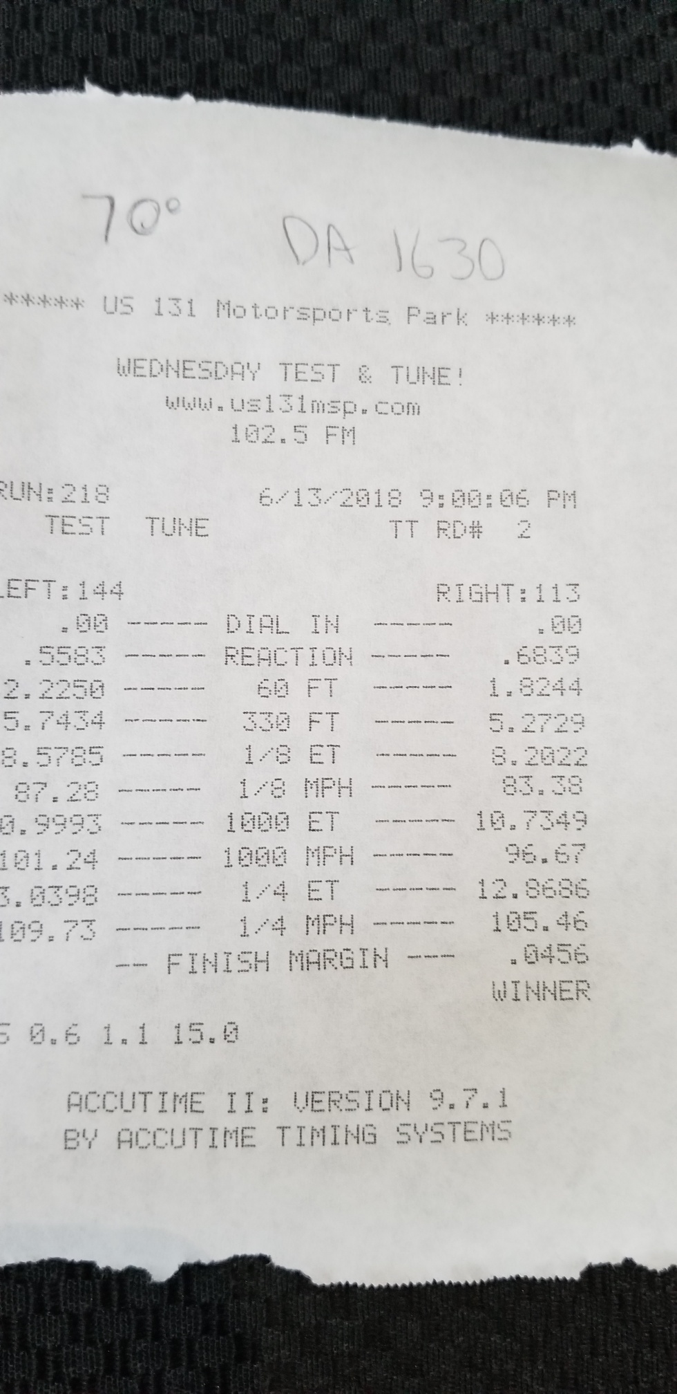

Well as of tonight I now have a 12 second truck. All the passes were brake stalled to 3200rpm, 4wd launch, 2wd after the launch, and 6200rpm shift points. Mods ProCharger P1-SC 10psi @ 6200rpm, Circle D 278mm 3200 single disc, Klug Performance tune, Black Widow 250 custom cat-back, Falken Wildpeak AT3 tires 265/65R18, stock 3.42 gears with a 6 speed, and full street weight of 5500lbs with me in it. Very very happy with my results from tonight. I can't say thank you enough to Zak with Klug Performance for all the hard work on the tune.
First pass: 13.04@105.07(1/4), 8.35@82.69(1/8) with a 1.93 60ft 75 degrees DA 1965
Second pass: 12.86@105.61(1/4), 8.20@83.61(1/8) with a 1.85 60ft 74 degrees DA 1893
Third pass: 12.88@106.81(1/4), 8.28@84.40(1/8) with a 1.95 60ft 70 degrees DA 1629
Final Pass: 12.86@105.46(1/4), 8.20@83.38(1/8) with a 1.82 60ft 70 degrees DA 1630

Damn you busted out some serious MPH on that third pass!

Thanks. Yeah I am not sure why that one pass the mph jumped like that in the 1/8th and 1/4. I didn't do anything different from the other passes. Maybe when the Audi R8 I was racing went flying by me on that run it boosted my mph....
