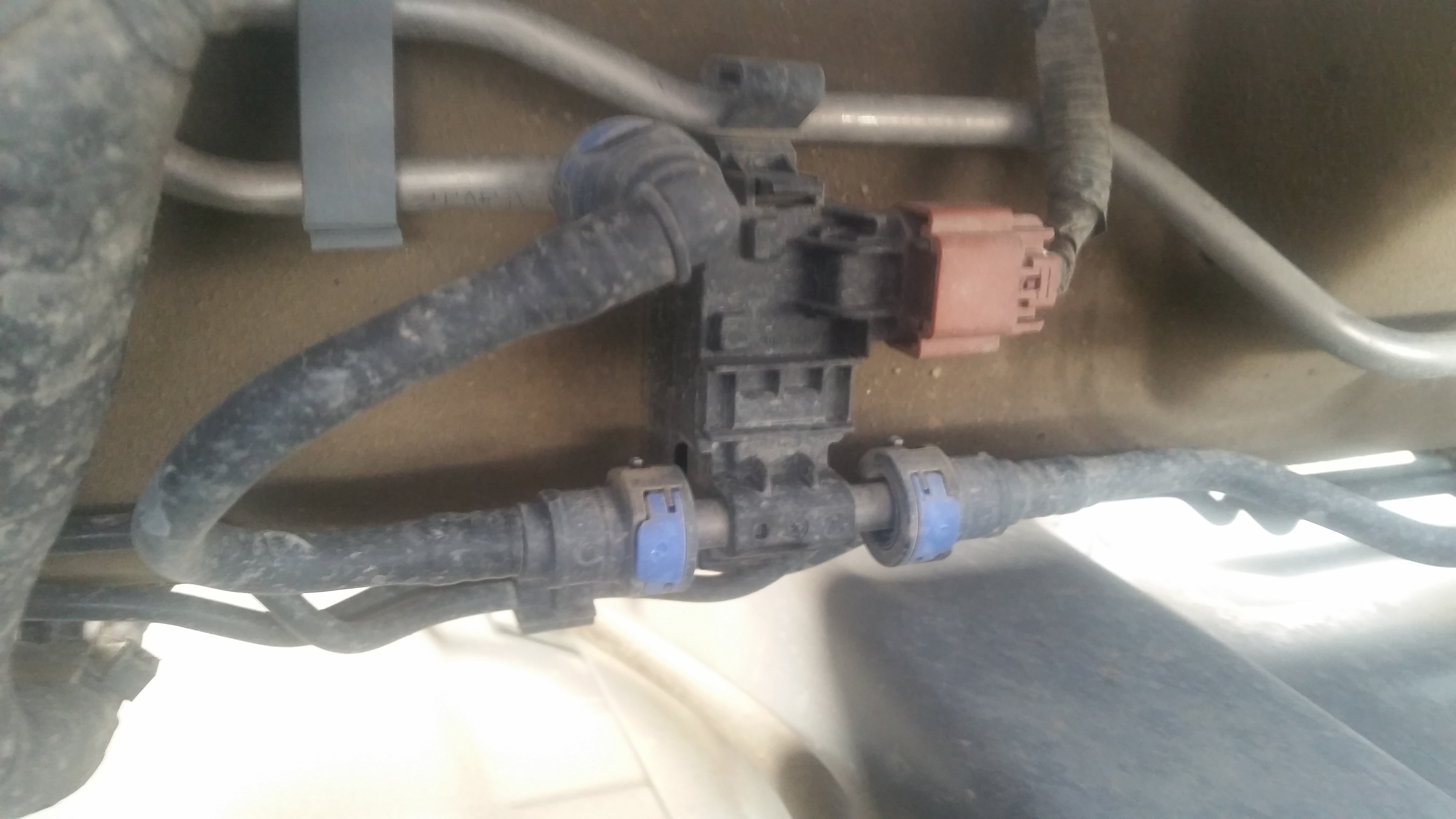

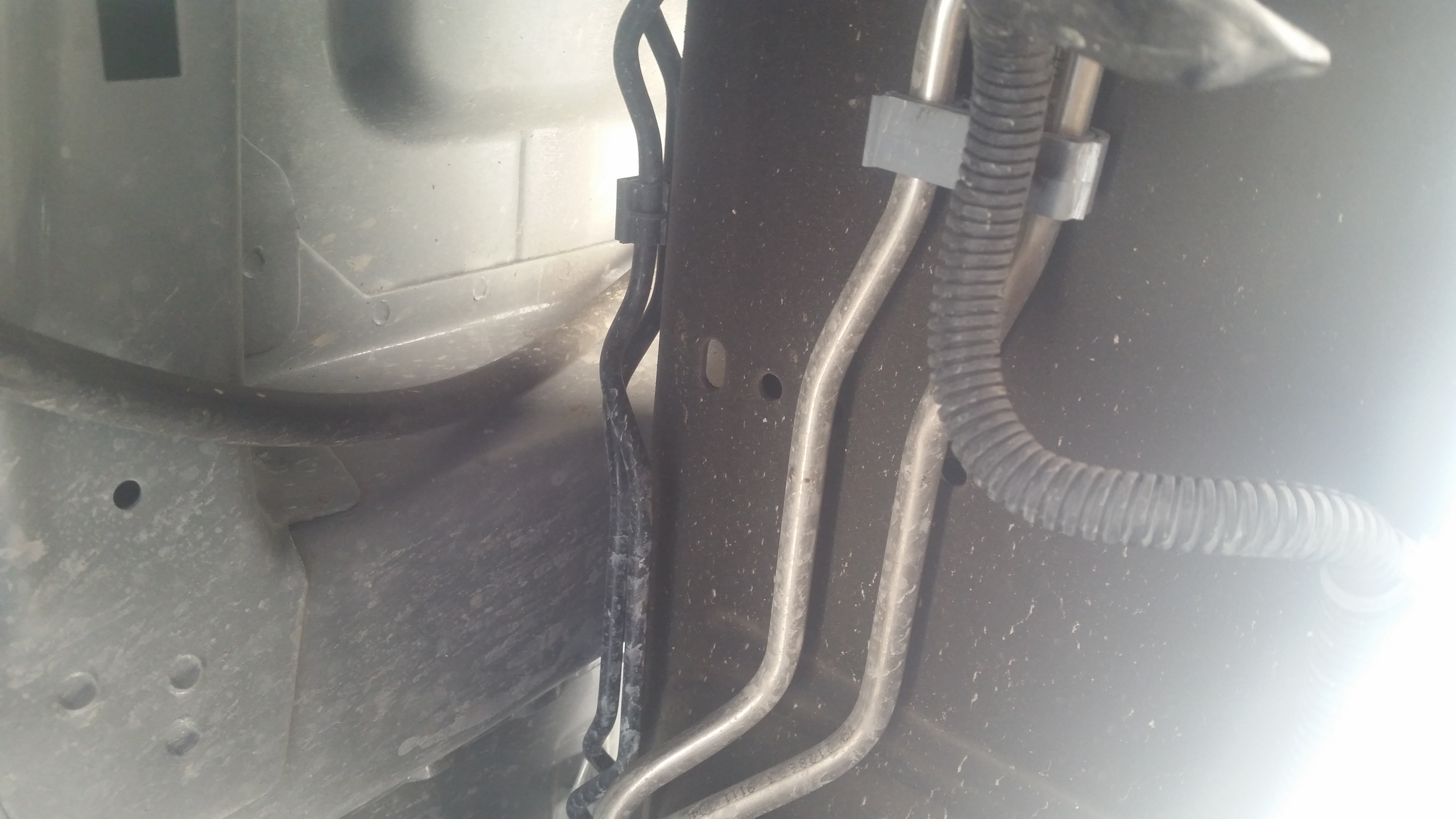

Pictures are hard to see how he did it... in all honesty I'm at a loss. I'm now trying to figure out how to add the sensor to the line, it looked as if I would have to cut it, but I don't know what to use in order to reconnect the lines. Here is a picture of 15' 6.2 fuel lines how it's ran (lst picture) and my buddies 5.3 fuel lines (last two pictures).
Edit: for some reason the pictires are upside down and it won't let me rotate.
Attached Thumbnails E85 on 2015 6.2-20151125_104153.jpg   E85 on 2015 6.2-20151125_103616.jpg   E85 on 2015 6.2-20151125_103609.jpg

If you purchase the 3 pieces from a FlexFuel 5.3 you won't need to cut anything. The sensor goes in after the 1st piece coming off the tank if I recall.
If you just purchased the sensor it won't just fit in somewhere, you'd need to splice the fuel line to do it. I didn't do it that way.
