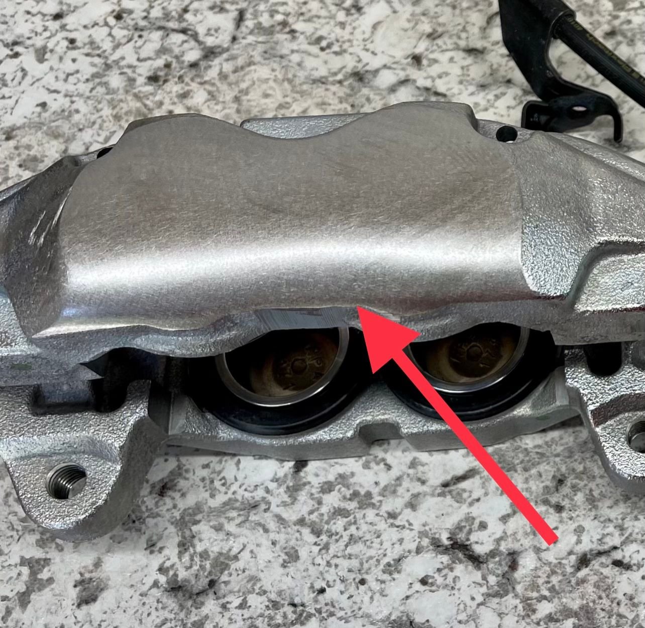

Fake shake is correct, even with double 1/4” spacers stacked, and the hump ground down it touched.
Oof...so really there's no other purpose to mill that section down besides aesthetics.

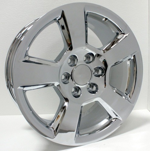

It was 100% necessary for me to grind the hump to run GMT900 LTZ20s with those brakes. It was still so close it gave me goose bumps so I ran a 1/4” spacer at that time.

Maybe a hair off but measuring the face of the calipers when lined up at the caliper mounting locations, the 4 piston sticks out .880 further. I understand that’s not the whole story consider WHERE it sticks out. We need a drawing or a side view to actually determine where it matters. Oh, and I mill down .350-.375” to get rid of this bump.

I think these need to be tried at some point. These are both off the Dodge Ram 2019 +. Both are 18 x 8 with I think a ET 19 offset. The barrel doesn't stick in like it does on Chevy wheels. Looks like the barrel will clear, and the spokes on both might clear (first one looks like a better chance), might need a spacer, but this design looks close. I see sets of these are pretty cheap.

Most barrels will clear but the spokes are the killer
