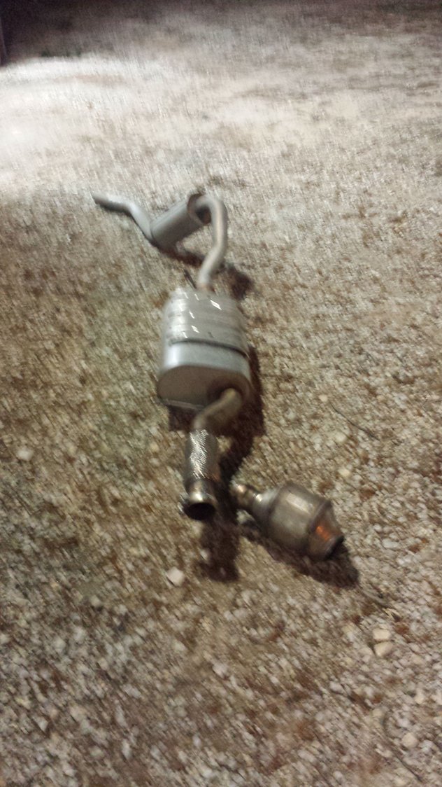

Old Sep 30, 2015 | 09:50 AM
formula53's Avatar
Joined: Sep 2014
Posts: 29
This is what cut off my 15 pm me and I can send you the flange you need.
