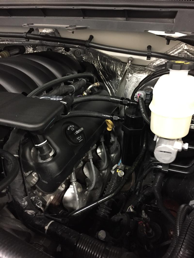

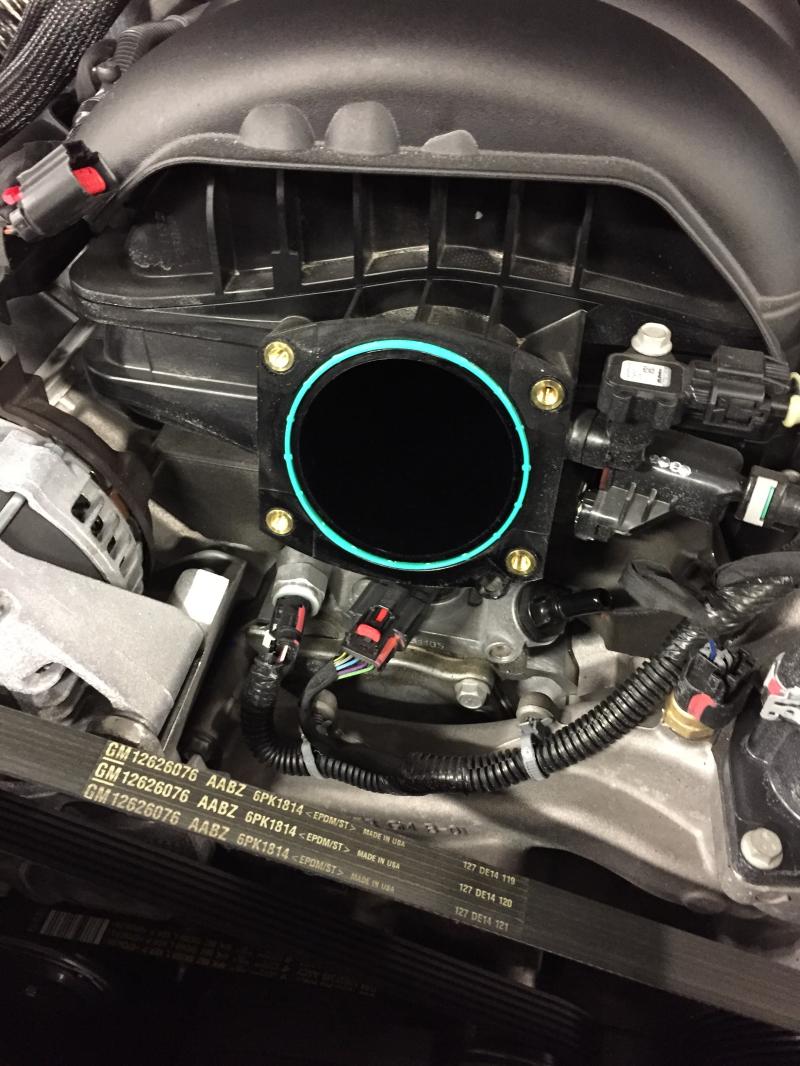

Decided to install a catch can asap to help with any carbon build up on intake valves. Its a Mike Norris catch can. Once I pulled the intake tube and throttlebody I wiped out the intake, I basically had nothing in the intake but my truck only has 4k on it so I didn't expect anything crazy. Mine is a 5.3 so the crankcase vac. tube runs from under the TB to the drivers side of the intake manifold about half way back.
Nipple below where the TB mounts.

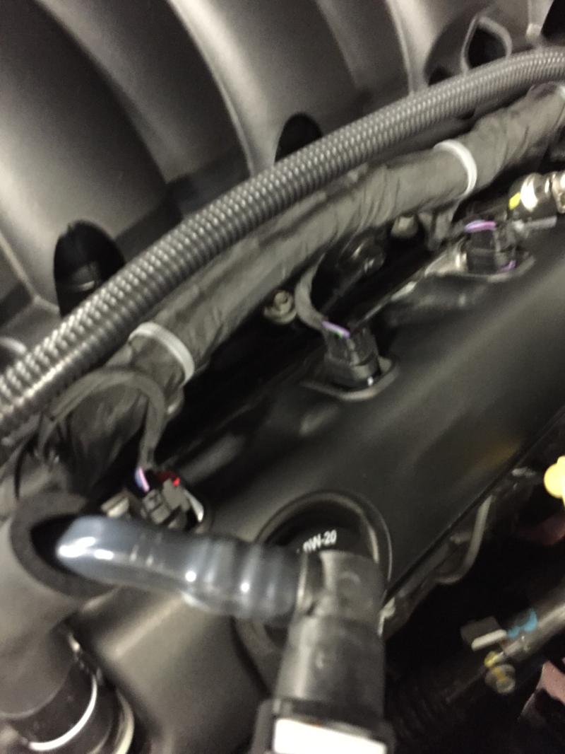

Attachment point on intake manifold.

With the New lines attached.

I attached the catch can bracket to the brake master cyl. mount bolt.
The Top line on the catch can runs to the port below the TB, the bottom line on the catch can runs to the intake manifold.
Guess we will see how much I get in it.
