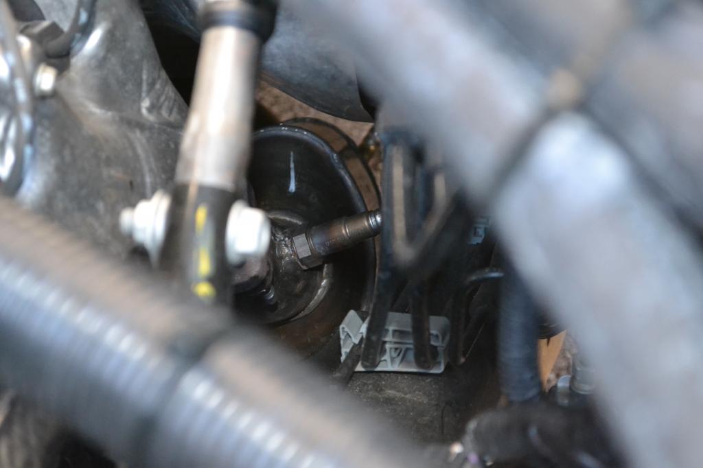

Originally Posted by AKlowriderZ71
I'm very aware of where that pipe is, and how it's situated in the truck. Just trying to save you from replacing that WB o2 sensor in 6 months.
thanks
I was thinking how we put it it would be good from any condensation. Id say its at the 2 oclock mark

AKlowriderZ71's Avatar
11 Second Hall Moniter
Joined: May 2008
Posts: 11,651
Likes: 10
From: Wyoming
Ahh, I can see it better now! Looks good to go man!

JCunningham's Avatar
Joined: Jul 2012
Posts: 787
i knew when I posted that pic that it looked wrong
