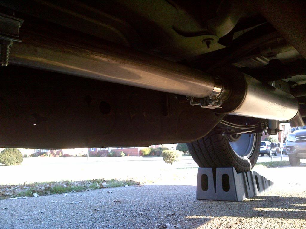

Hey guys, I installed an exhaust on my 4.8l rcsb for less than $250! I was looking into the Magnaflow system that dumps before the axle, but was concerned that the muffler that they use would be too loud since my cats are empty .
So, I purchased a magnaflow 12641 muffler, which is a 30", 6" round muffler with 3" in and out. I then purchased a 5 ft section of 14ga 409 stainless pipe from ebay as well as a 30* bend section of 16ga 409 stainless with 3 -3" band clamps.
The 14ga stainless pipe is REALLY thick, and I'm pretty sure it will outlast the rest of the truck. I cut this piece down to 27".
I then cut out the two bolt ball flange connector about 1" back on the y-pipe, since it tapered down to a 2.75", butted the 27" pipe against it, added a band clamp. the magnaflow muffler then slipped over the 3" pipe and I clamped it together. The band clamp lined up with the hanger, so I used a piece of 3/8" rod bent it to slip into the hanger. I used the last band clamp for the 30* bend and it lined up to the second hanger, so I used the threaded rod with washers and nuts bent to fit in that. Anyway, check it out! The 30" muffler sounds great, a little loud without cats, but it's not too bad.

Old Dec 4, 2013 | 10:21 AM
DTHPROOF's Avatar
Joined: Oct 2011
Posts: 757
From: Havelock, New Bern, Newport, NC
Nice. I need to do something with mine. Mine dumps before the bed after the y-pipe and a tiny Magnaflow bullet. It's too dang loud. When I did this exhaust I was driving 15 minutes per day or less. Now I'm driving 30 minutes each way to and from work and it's killing me.
Old Dec 4, 2013 | 10:22 PM
Ryan Mills's Avatar
Joined: May 2012
Posts: 157
From: Mechanicsville VA
This 30" monster seems to do pretty good, even without cats. It's a bit louder than the stock muffler, but not so loud that it's annoying.
Old Dec 5, 2013 | 12:04 AM
iamkeniff's Avatar
Posts: 5,365
From: Gonzales, la
Id weld those connections before those band clamps wear out.
Looks good
Old Dec 5, 2013 | 07:23 AM
Ryan Mills's Avatar
Joined: May 2012
Posts: 157
I've had pretty good luck with the band clamps. I had the same muffler on my GTI, and it worked well for over two years. Knowing me, I'll probably switch it up in a few months anyway, and do a v-band connection and weld the rest.
