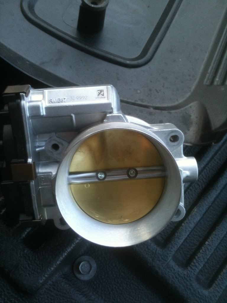

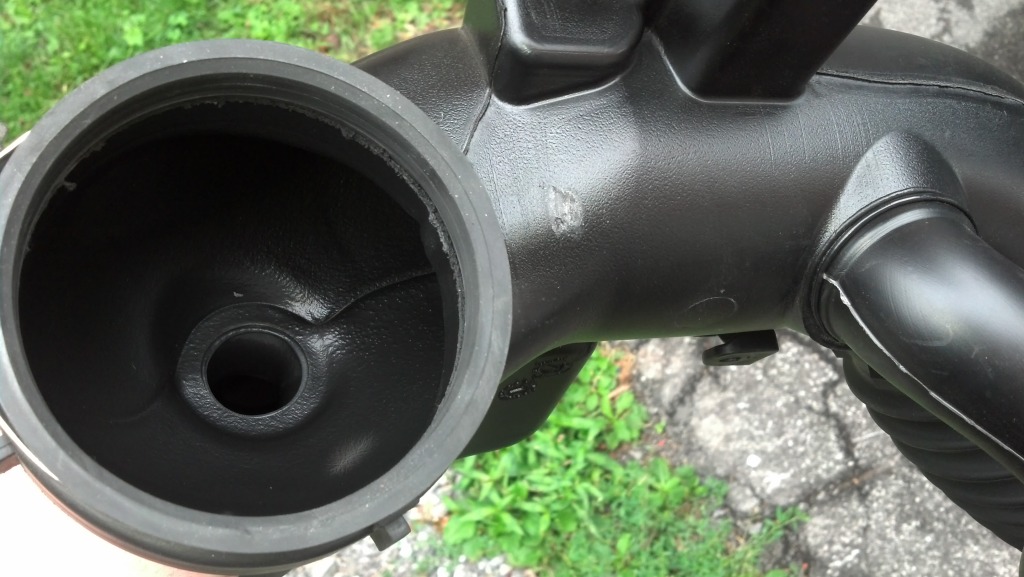

i have this one 261105109 cant flip this one the
you can see were it hits
I never got a email back from them on what size they bore there tb to. The one on ebay would fit fine but if its bored to 87mm then it would be useless as the 6.2l is already 87mm
