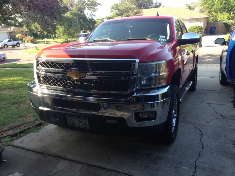

I finished mine up a few months ago, have a few pics of the chevy HD bracket on the thread I had put together. https://www.performancetrucks.net/fo...t-info-525200/
The chevy hd frame brackets are a 1/8" Narrower than the stock 1500 width. The gmc frame is the same in measurement from the chevy.
I found my bumper on craigslist and the rest from ebay and my parts man from dealer, got a really good deal on the hood from lqk, a couple of small minor dent works dent removed.
I did find that the hd bumper fit fine with the stock grille and the hd grille fit fine with the factory bumper. Only thing was the corners was rounded and the bumper was squared looked ok but was noticicable
