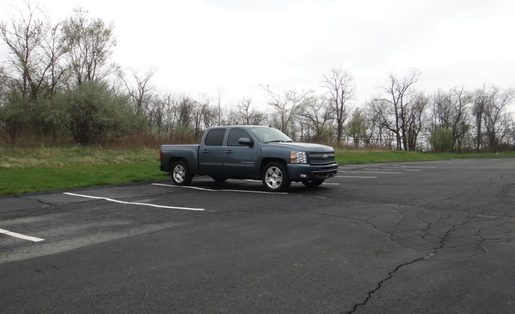

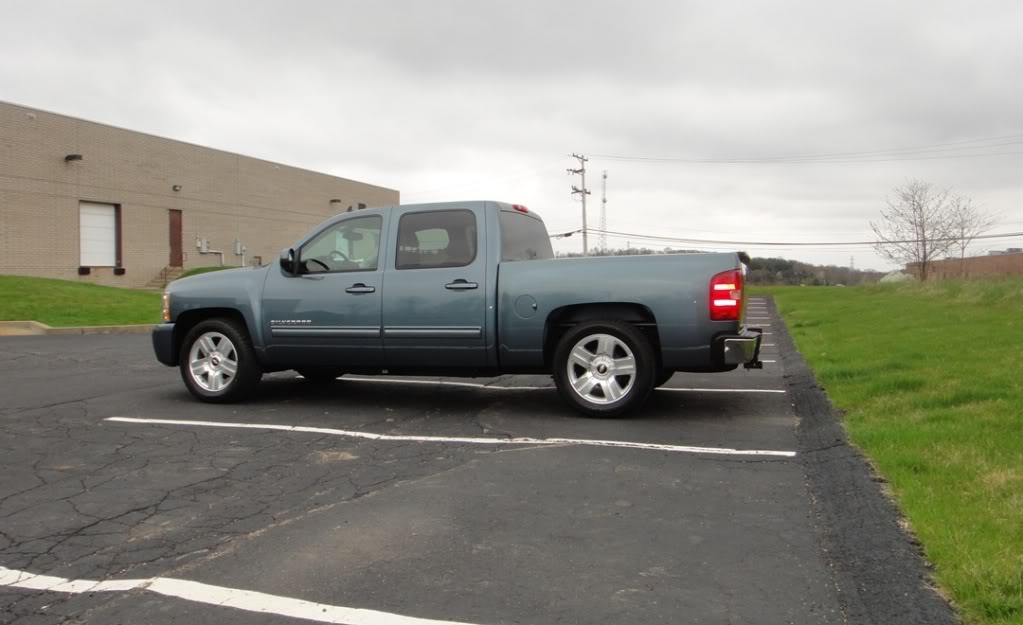

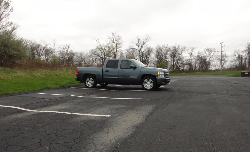

Few more pictures.
If any is interested I will snap a few pics of the back and how close the bump stops are to the rear axle... I have yet to trim mine but they still aren't touching. I wouldn't go lower than 4" w/o cutting the whole bump stop mount off unless you never put anything in your bed. At first I was worried about the spring/shackle hanging too low because the hanger flip lowers the spring mounting point and the shackle is longer than the factory shackle, but as you can see... well you can't see the rear shackle hanging below the bed
