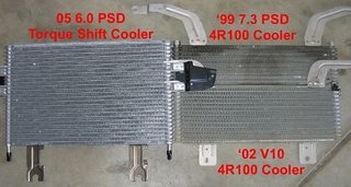

Well I figured since I did things alittle different why stop now lol!! So I was looking for a trans cooler. Everyone agreed the TRU COOL 40k is the way too go. In researching I saw someone on another truck forum suggest a 05 F250 6.0 trans cooler. After researching that alittle I decided to try it out! Check out the size of this ****!! According to the Ford guys the 02 v10 excursion cooler is the same as the TRU COOL 40K
It has 1/2 male end outlets to slip the hose on with a clamp. I ordered the Derale 3/8 hose compression fitting to 3/8 barb and 3/8 barb to 1/2 bard reducers.
