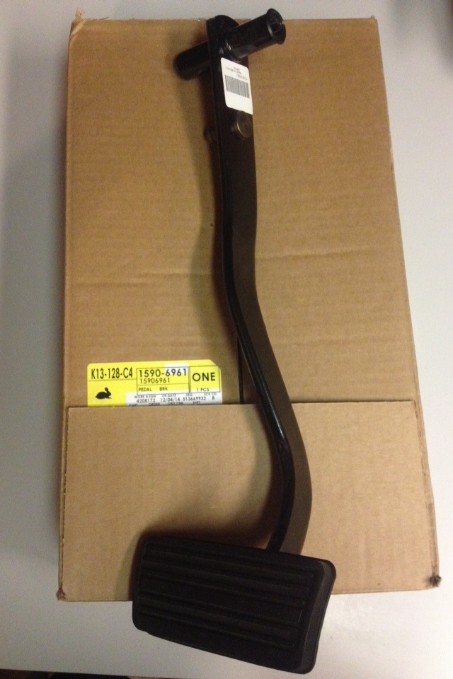

as for the pedal, it seems to be the same size as the factory one (length wise) from the bottom of the sleeve for the bolt to the top left edge of the brake pedal rubber is about 14 1/2" just like the oem one.
Brand new pedal from GM
part number 15906961
Hoses used:
part number: booster to rack GM 19147663 Ac Delco: 365466
part number: booster to pump GM 19147651 Ac Delco: 365454
part number: return line Gates 363520
Booster:
part number: Ac Delco: 1780854
part number: Master Cylinder Ac Delco: 1741137 GM: 19209189
