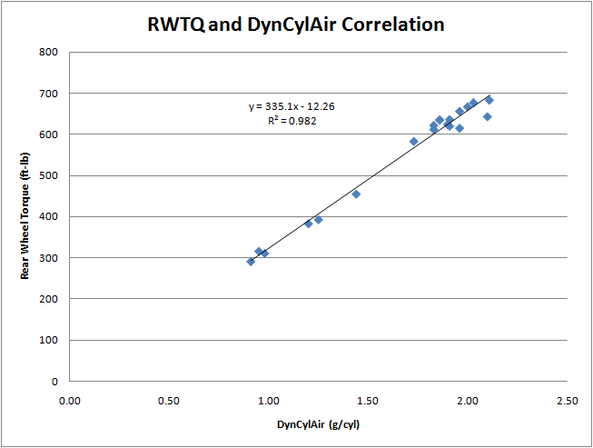

I used g/cyl at one point and compared to my dyno runs to make a sort of curve...not sure how accurate it is.

Yea dynamic airflow is a good number to guesstimate with. If I remember right, 0.01 g/cyl is around 4.5rwtq. Should put you in the ball park until you peg the g/cyl hard limit.

food for thought...
