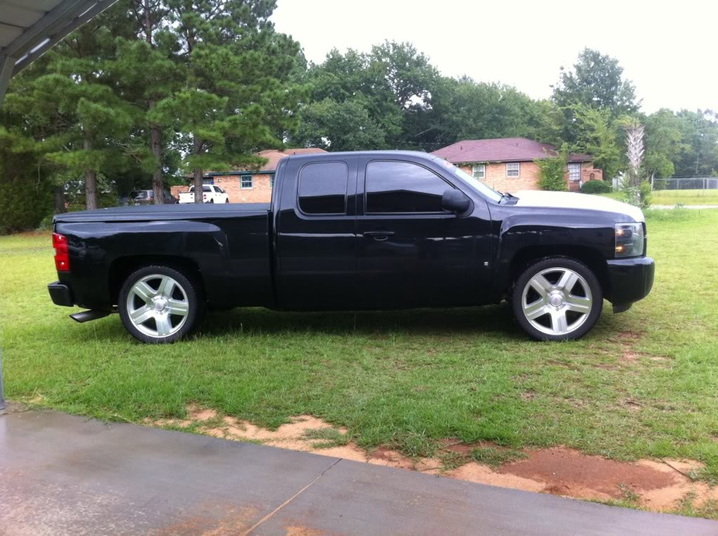

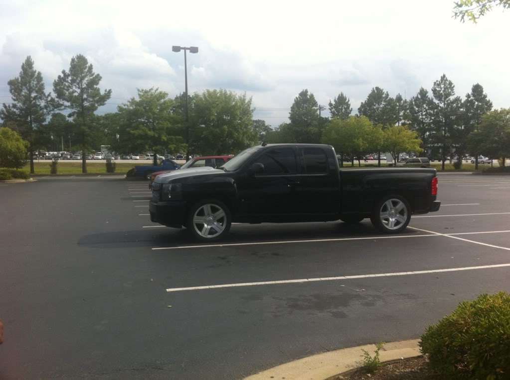

Btw. Here's my new truck

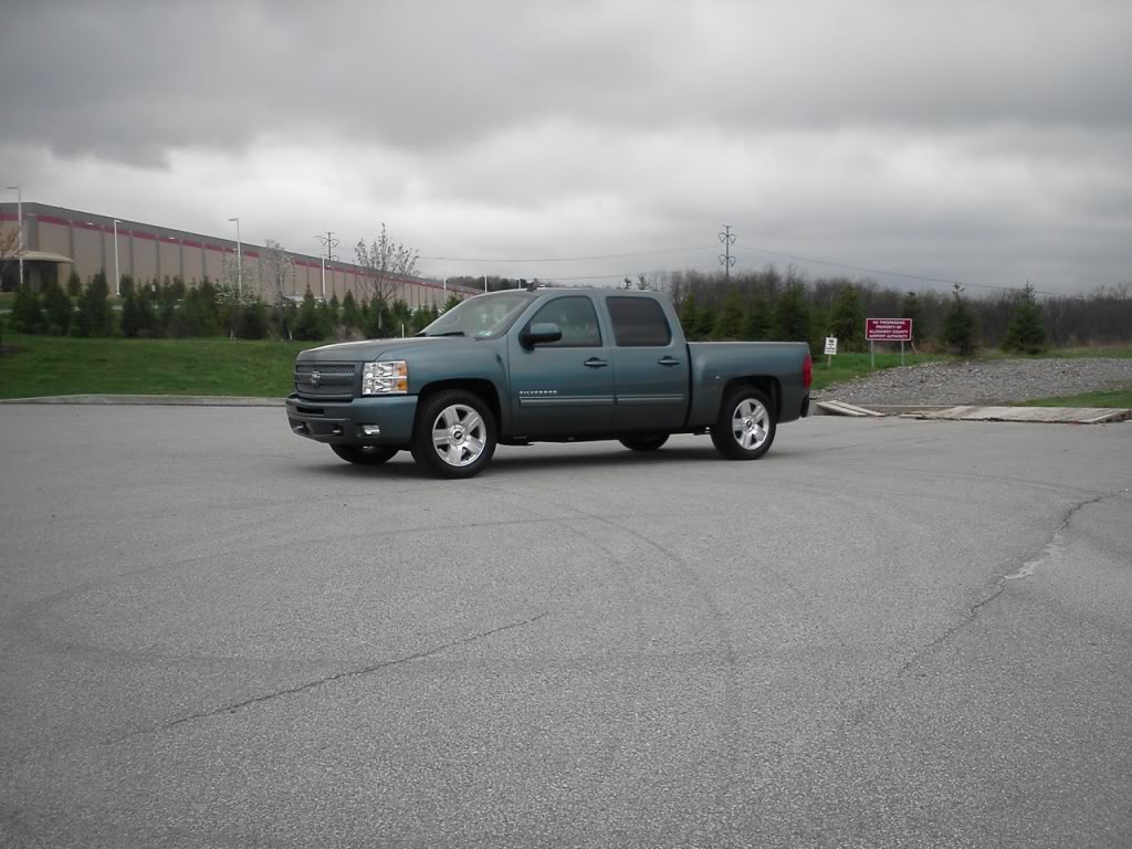

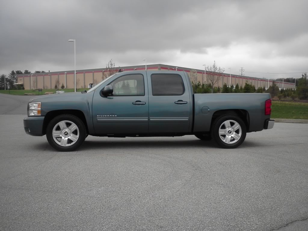

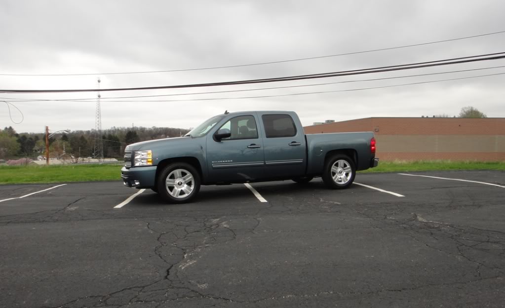

My 11' was 2/4 dropped using
Belltech adjustable struts for 2" up front
DJM rear flip kit with hanger lift to bring it back up to 4" in the back
No notch, never even changed the rear shocks. I loved the struts as it just firmed up the ride to where I liked it and got rid of those shitty bouncy Rancho shocks that came on the Z71s... and also retained the factory turning radius which is a huge + in a crew cab.
tires are 275/55/20s
