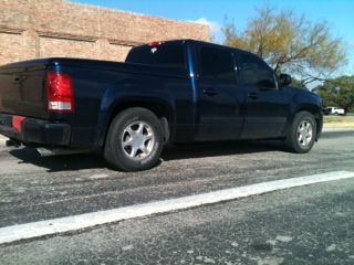

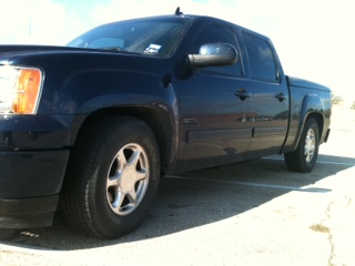

Here it is 2011 GMC 6.2 3/5 4x4

Thanks, that looks good man!
