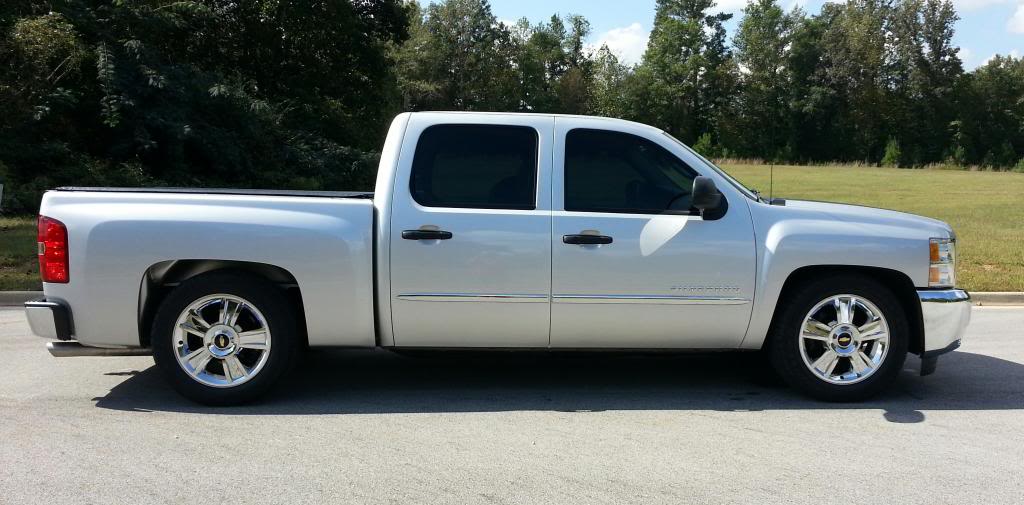

32" tall tire is the factory size tires. My 13 crew cab dropped 4/5 on the factory 275/55R20s ate holes in the front fender liners on a daily basis. I could fit two fingers between the top of the tire and the fender liner, roughly 1.4" gap.
