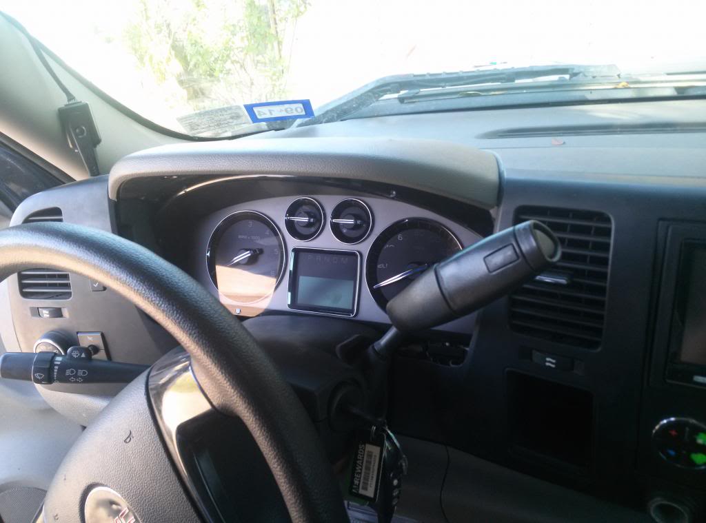

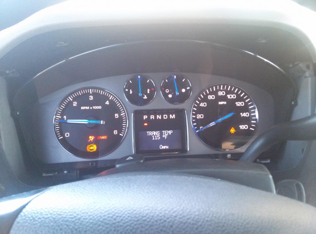

installed the escalade cluster in my nnbs 08 gmc. it wasn't easy, but i got it. looks a bit off in the corners but it looks good overall. love the digital speedo option this cluster has, here's a vid and some pics of the install. disregard all the lights on the cluster lol

cluster looks good..is there a filler piece or something that goes underneath it to fill in the space on the sides?

How does your 4 speed work with the clusters PRNDM? It doesn't throw it off?

can all the lights be cleared off and stay off?

@ musclecity - wish there was a filler piece, im sure one can be made tho with fiber glass
@ Three6GMC - it works fine. only when i downshift to like 3,2 or 1 the indicator stays on D.
@GreyGhost - i'm running a 4x4 ecm and my truck isn't 4x4 thus all the abs and brake lights. the lights were on on my previous cluster as well, they weren't caused cause of the escalade cluster.

nice i got the caddy cluster and the plug for it. i never ended up putting them in tho cuz i herd you cant get rid of the suspension light
