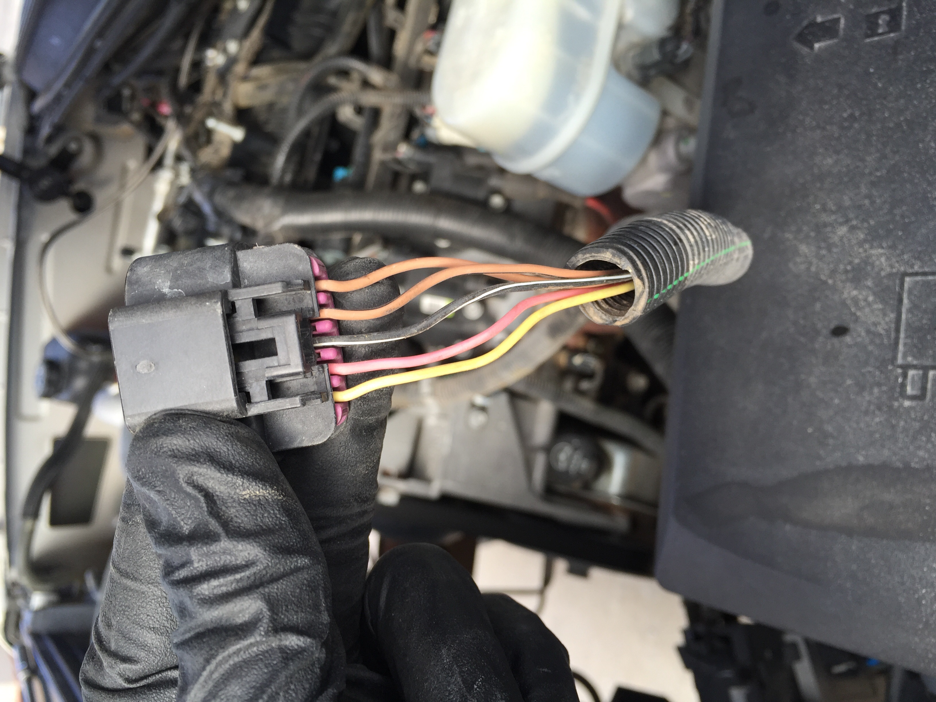

Going sd for my tune and I'm putting a iat sensor in. Can anyone help me with what 2 color of wires I need or have a pinout? Very much appreciated

Is your wiring like this?
A. Yellow
B. Pink
C. Black with white stripe
D. Tan with black stripe
E. Tan

It's gonna be your last two wires. The tan with black strip and the tan one. These are your AIT wires
In your truck the last two wire colors may be solid tan and solid black.

Ok Jordan let me take a quick look at it and I'll get back to you

It's the last two wires. Your second to last one is your AIT signal wire and the last wire is your low reference wire

It's tan and tan and black. My iat sensor has 2 black wires so I'm assuming it does not matter how it's wired
You should be good then! How much boost are you running? And why going SD?
