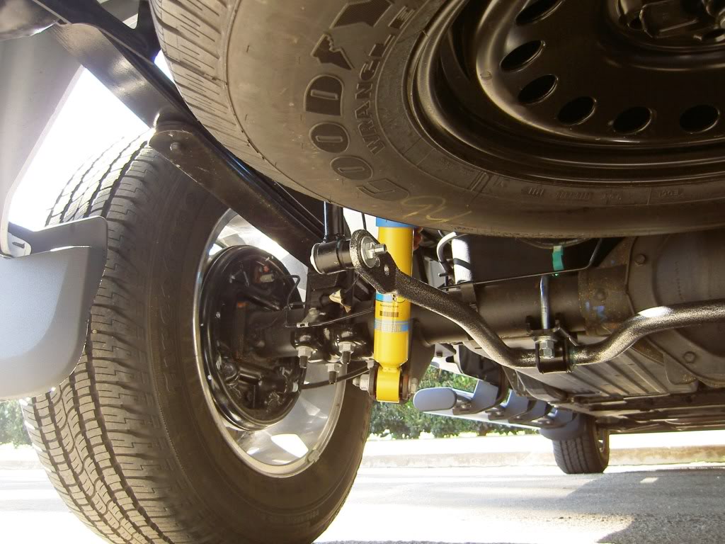

Indeed. Install Hellwig’s #7800 rear bar first, as it’ll make a dramatic improvement in chassis balance and control for less than ~$250.
Subsequently upgraded to their #7685 1.5-inch(!) solid front bar and F&R Bilstein shocks.
Should have been screwed together like that before it rolled out of Fort Wayne. ;)
