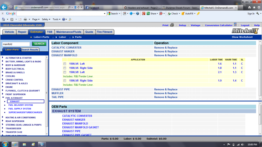

Here's the Mitchell labor times. Regardless of what this says, you do not need to remove the inner fenders, and it does not take this long to do. It's an easy job, and if you can do basic mechanics, you can install ARH headers. They go on VERY EASILY, just ask around or read the others' posts.

ok thanks. ya I can do it my self. just sucks that i will have to do it on the ground. I had back surgery in march so it mite not be to fun. Nice thing is the truck is new and the y pipe has been out once for the wide band o2 bung. I have very good air tools too. At least ill know the header bolt will be torqued and not just zipped on with a air rachet and the pipes wont be bent from the band clamps being zipped on from a impact. no wires touching. and so on
ill have to do 11ftlbs then 20ftlbs tho. My snap on tq wrenches are only 40-200inlbs (16.6ftlbs) and 20-100ftlbs
