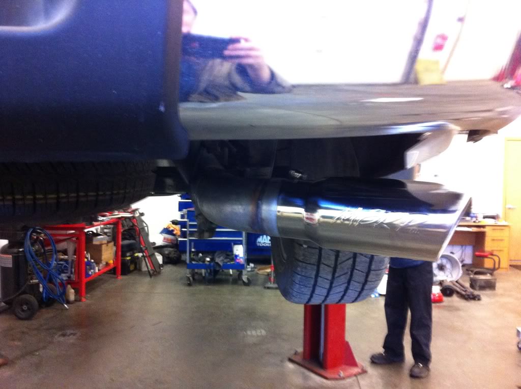

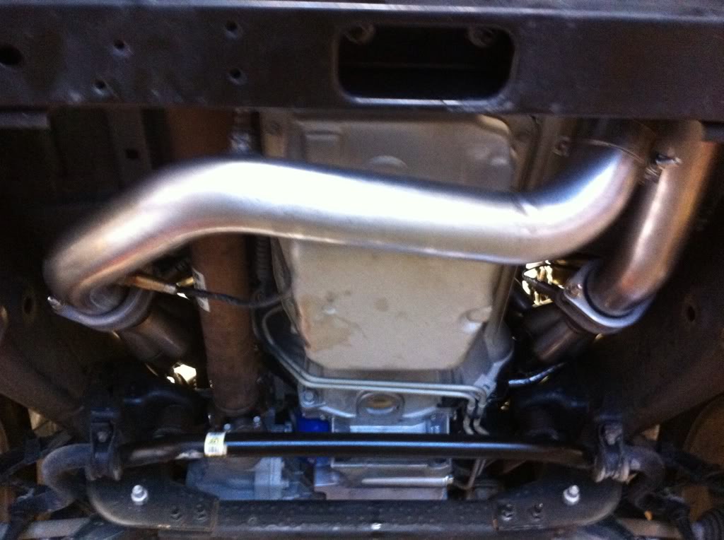

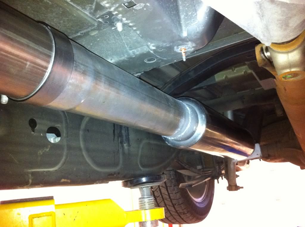

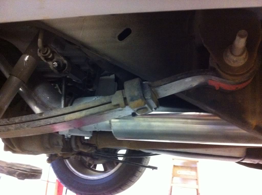

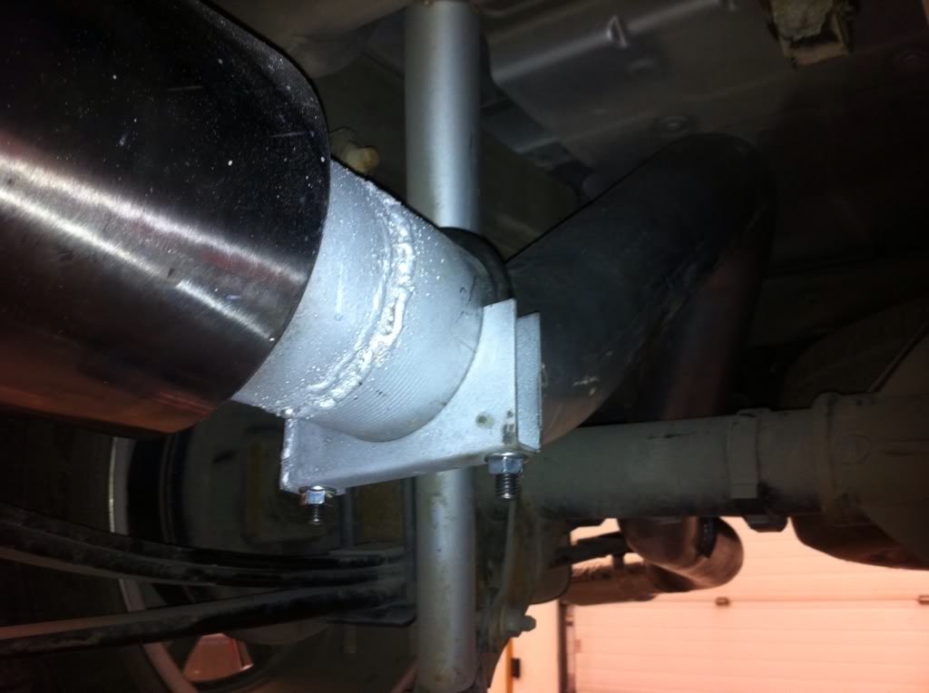

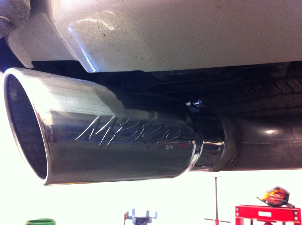

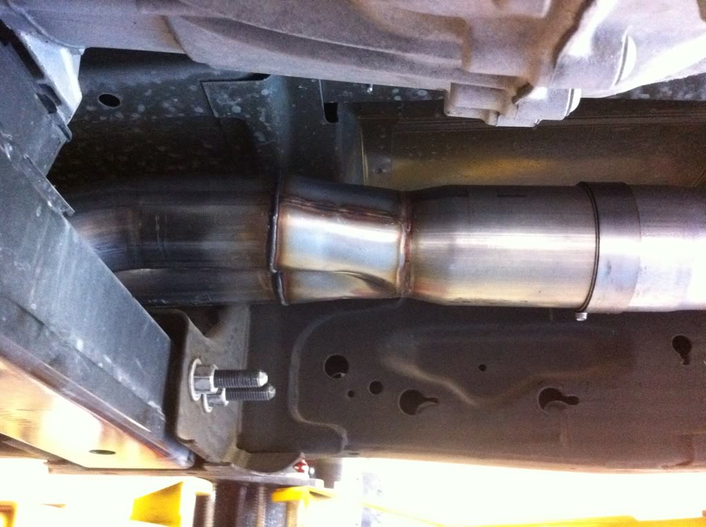

But to do a 4" the right way IMO, I have ARH build me a custom y-pipe. I suppose you could buy a 3 to 4" merge pipe to accomplish this, but those are expensive....
Here's a few pics, and an idle vid. This is the MBRP diesel kit, with a catless Y.

Idle vid is inside the shop, so there's some echo...
