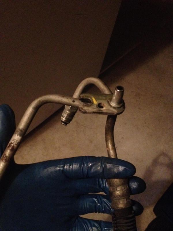

Factory fitting at the Rack. Def a bad GM design for us that want hydroboost
