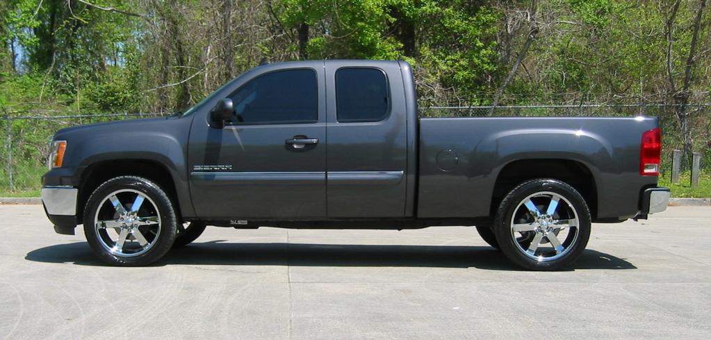

just shackles....

I dropped the hitch and pulled the blocks out and swung the leafs far enogh to the outside to remove the top bolts. I also put shackles which makes it a little lower than the front. It took about an hour. Ordering spindles today. I'm thinking McGaughy's...
