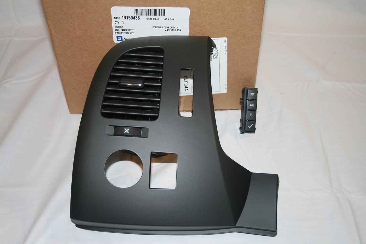

Old Sep 16, 2013 | 04:56 PM
Posts: 66
From: Las Vegas, NV
Just searching old threads for DIC info...
Came up with GM p/n 19159438 for the WT and SLE... The SLT supposedly had the buttons on the RH side and I haven't found a p/n.
Supposed to be plug and play.
Attached Thumbnails Driver Information Center 2008 Sierra SLT-19159438-dic.jpg
