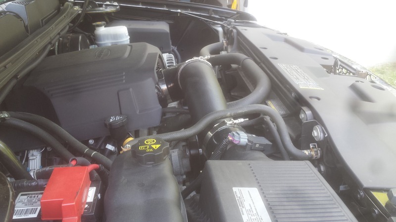

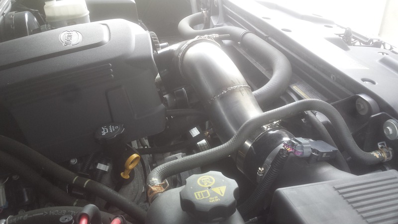

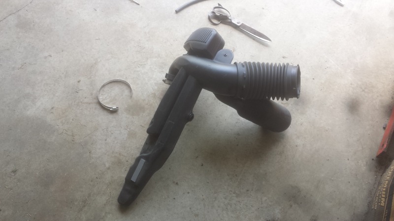

Anyways, I am planning on basic modifications for this truck or the wife will kill me. I recently ground out all the grooves in the stock airbox and the lid as well as opened the inlet side of the box (towards the fender). I also matched the fender by cutting it with a body saw. Today I removed the stock intake (maze) tube and made my own intake. It's made from 4" mild steel tubing and uses a 3.5" x 4" silicon coupler on the MAF and. 4" elbow on the TB side. I also made a bung that I welded to the tube for the PCV line. Lastly I secured it using T-bolt clamps. It's not finished but functionally it is done.

Looks good! Now all it needs is some matte black paint on the piping! great job though!

Looks really good. Lets see the rest of the truck!
And watch for surface rust etc on that intake tube. I think most people use alum for a reason.

DEI high temp ceramic paint, inside and out.

All ground down and painted with Rustoleum Professional Bedliner spray. I think it gives an OEM type look. Also a (bad) picture of the truck. Next is a Blackbear tune via Autocal...

I like the look of that intake tube a LOT. Nice work, dude.
