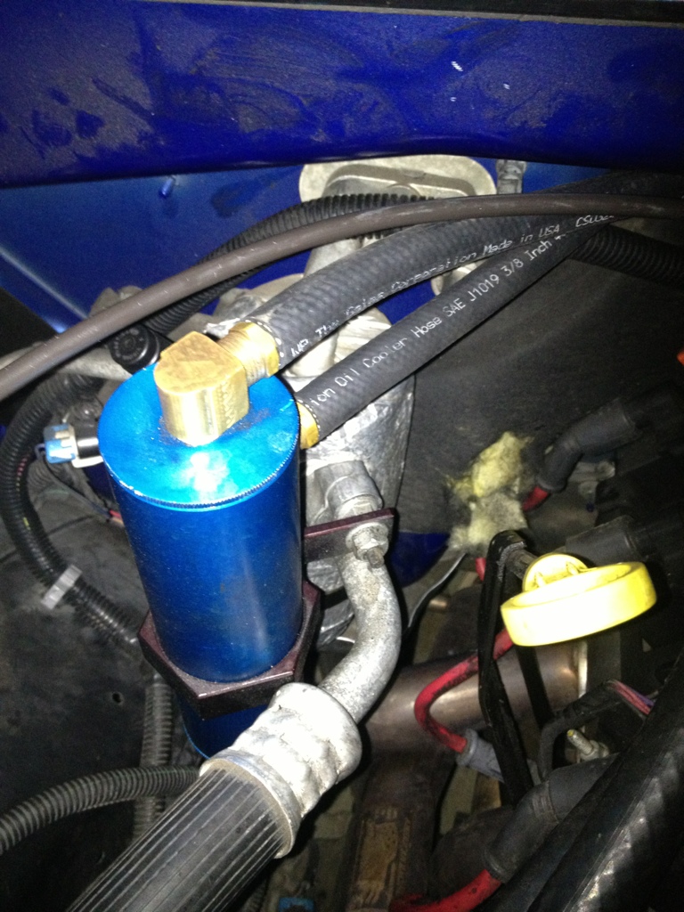

Anyone mount this somewhere besides off the side of the alternator?? Procharger has that spot on lock down and looking for ideas of a clean place to mount it

You could mount off of the engine on the right front inner fender in front of the fuse block. That was my alternate location. Or do you have room there? Which can are you looking at? BTW I am rethinking the Mike Norris Can. I am still getting oil in the intake. All be it a very small amount compared without it but I do not want any oil passing through.
I have mine mounted by the A/C receiver/drier canister on the passenger side and have my hoses run behind the intake manifold. Pretty clean mounting location and not really in the way of anything.

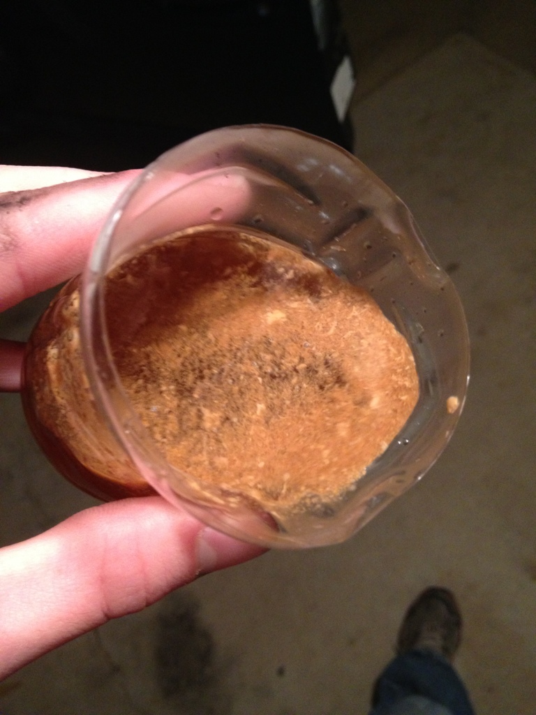

And THIS is what I found in my can after about a months worth of driving. Emptied it right before we left to go visit family for Christmas and this was at the end of January. Ive been having some surging issues ever since I installed my new injectors (late December) and still havent gotten that all worked out yet. This liquid was completely filling the can and is primarily fuel, mixed with some of the usual oil and condensation that I always got between oil changes. I'm still trying to figure out where in the hell all of this fuel came from or how in the world it got into my catch can of all places? Anyway, any ideas are more than welcome.
It can be mounted anywhere you can route the hoses to. But it will be more effictive if it is closer to the PCV valve.
