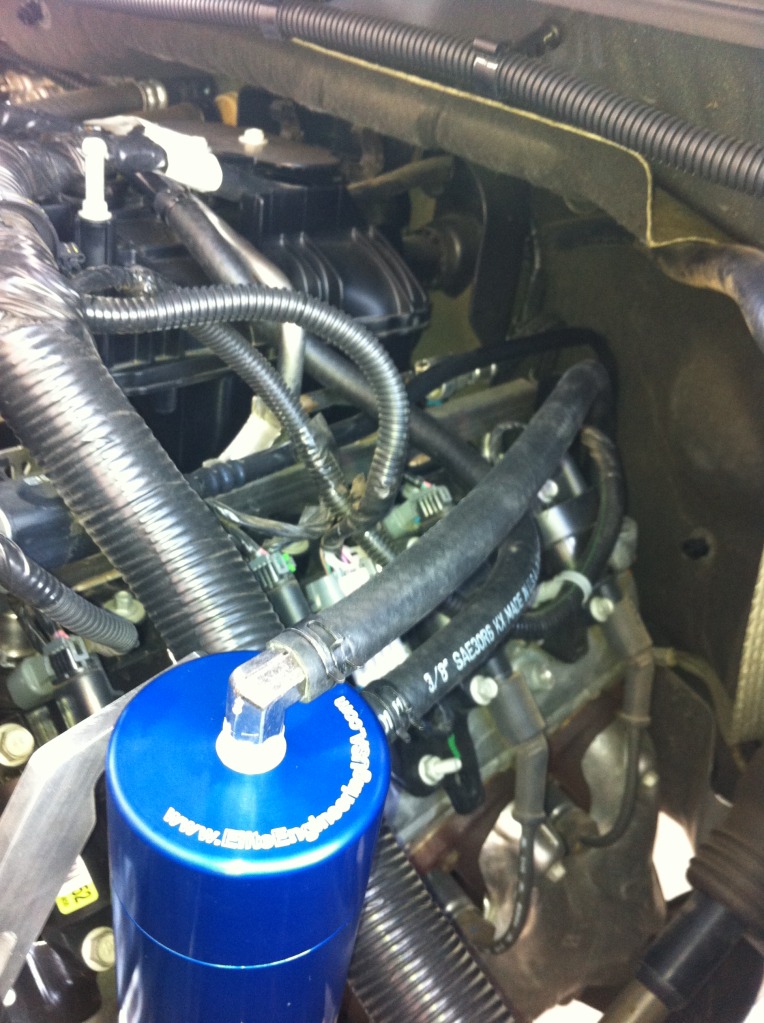

Installed this catch can today. I noticed on start up that there is a rushing air type sound. I definitely have no leaks in the hose going into or out of the catch can. I guess its just the sounds of the air moving threw the catch can. Only ran it for about 40 miles so far and nothing in the can yet. Anybody experience a similar sound after installing one of these?

Are u sure the can is closed? How is it idling?

Yes the can is completely sealed. The idle is normal. I'm pretty sure its just the sound of the air moving through the tubes and can.
