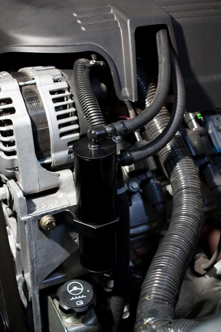

Preston you are correct about any engine benefitting from eliminating the oil in the intake. I installed this Mike Norris can I got from Beau @ Skoggin Dicky couple of days ago (pic included). It came with brass fittings that I didn't care for too much, but black paint cured that ! Will look at it at the next oil change in 3K miles. I also cleaned out the intake as far as I could go anyway. Couldn't get past the hole about two thirds the way in. BTW The hole? Is this just to keep the air velocity up in intakes on these engines?

Clean install! I like that mounting spot.
