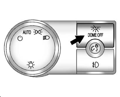

There is a dome override button to toggle that function off/on, you might want to check that switch.

Dome Lamp Override - The dome lamp override button is located next to the exterior lamps control.
(Dome Off): Press the button in and the dome lamps remain off when a door is opened. Press the button again to return it to the extended position so that the dome lamps come on when a door is opened.
