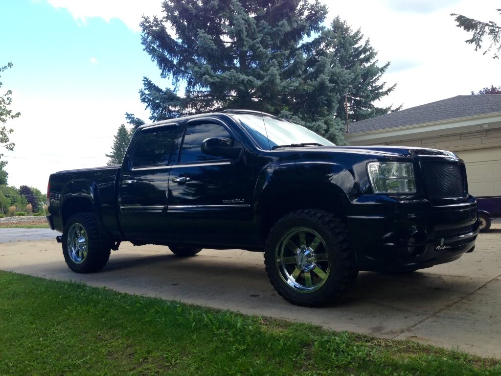

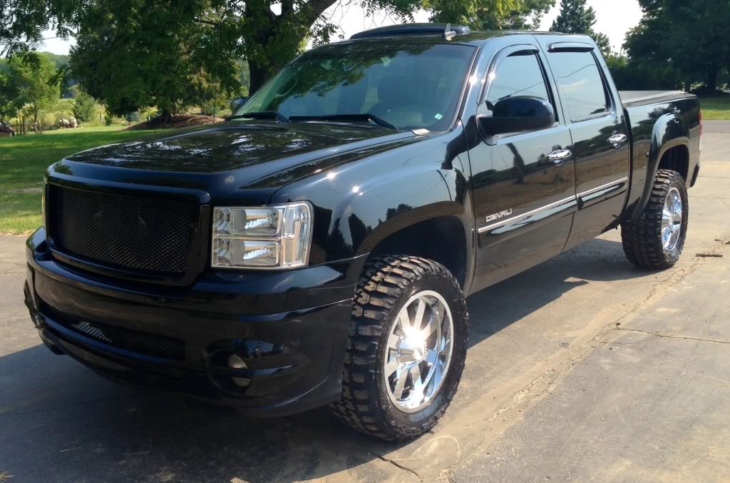

I see you possibly have a leveling kit ? Looks great , any issues w/CV angles or vibes ? How much is it lifted in front .

im just out side of lansing...yeah I put a 2in spacer in the front and a 3 inch block in the rear..removed the factor 1inch rear obviously..so its just up 2inchs all around so I could put these wheels on..i love the look it gave it no problems at all..but man o man did I lose a lot of power the tires arnt much bigger then stock actually. i expected to lose alil because of the rotating mass but now im thinking of selling them and going lower and lighter
