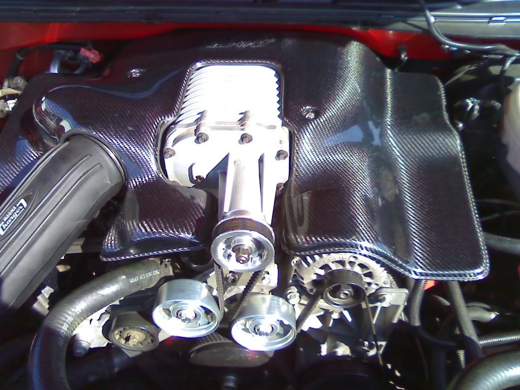

if function was all i cared about...why the hell would i have bought a denali?
this is under the hood of my silverado ss..so its kinda hard to pop the hood on that..and then pop the hood on the denali and not care lol but i get what your saying ..i guess its just havin a new toy and im lookin for some fun projects for it Name:  0827081647b.jpg
