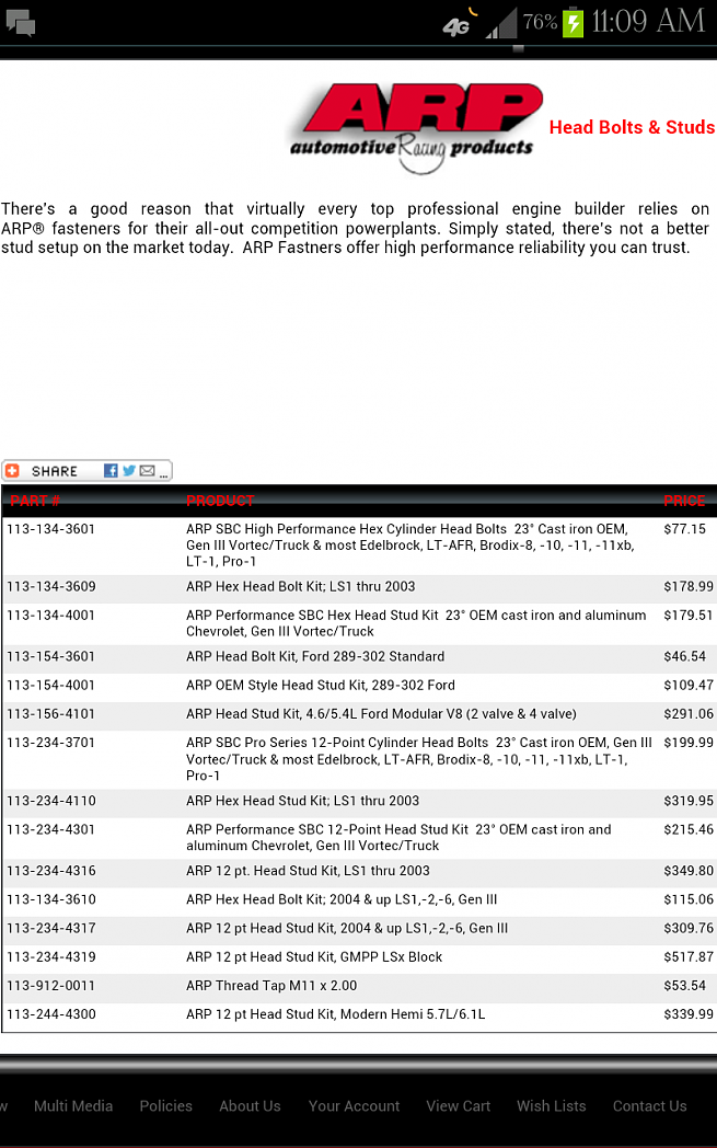

Just bought LS9 head gaskets for my 08 crewcab 4.8 LY2. Does anyone happen to have the part number for the arp hardware that is required? i searched online and could not find a specific one and emailed them and they told me to remove mine measure it and send it to them. Not a big deal except i am deployed at the moment. any help would be appreciated. Thanks guys. It is for a turbo application will be boosting 12#'s on a t72 kit. thanks.

https://www.performancetrucks.net/fo...1&d=1359825055
you need 04+ bolts or head studs

Got it, thanks man added to cart n checking out now

Here's the ones I got from summit. 234-4317 thanks
