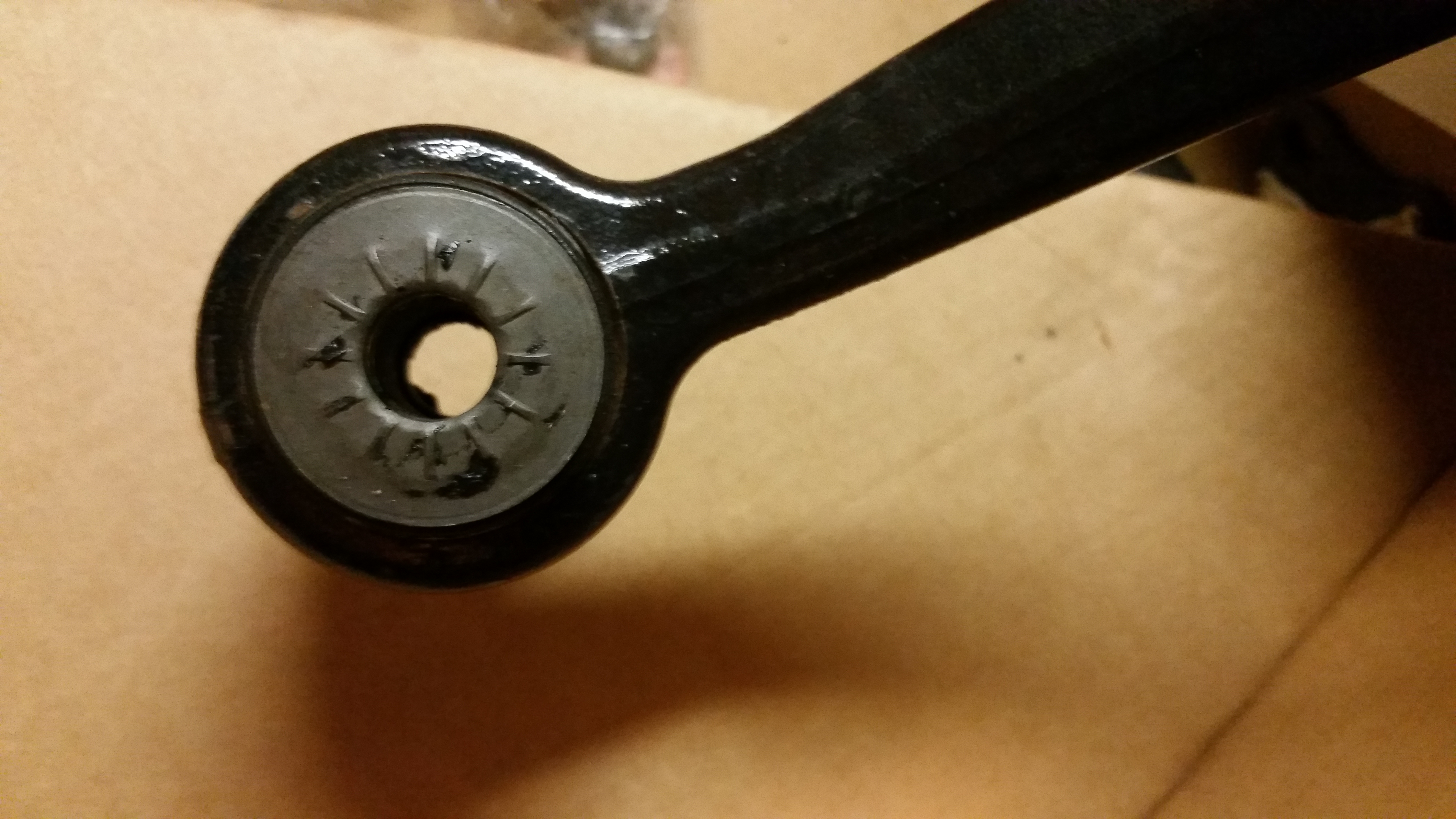

Can't keep it aligned? Are the upper control arm bolts slipping? Stock bushings have this raised pattern in them which probably helps them grip. The belltech bushings are flat. I have wondered about them slipping but havent had any problems.
Thighten the **** out of the upper control arm bolts/nuts with a 1/2" breaker bar
