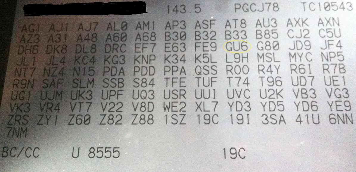

Easy enough to double-check what gears a GM truck was built with. Just take a gander at the option codes sticker in the glove box . . .
3.42 ratio = RPO "GU6"
3.73 ratio = RPO "GT4"

Here is what mine says.
So anyone had the 4.10's?
Or know where to get some?
6.2, 4W Discs, 3.42 locker, NO NHT package.

NHT is Max Trailering Package, available with and ONLY with the 3.73 rear gear. However, the towing package (not NHT Max Trailering Package) can be ordered on any truck, enabling the towing options as well as the 3.42.
Anyway, moving along: I have the NHT, so my factory rear is a 3.73, and I still have plenty of thrust despite the taller tires. I would think that with a 4.10 highway mileage would fall, maybe even lower than mine. Also, as somebody else pointed out, unless you are considering taller tires as well, your first gear would be rendered almost useless. Have you considered maybe 3.73s?
