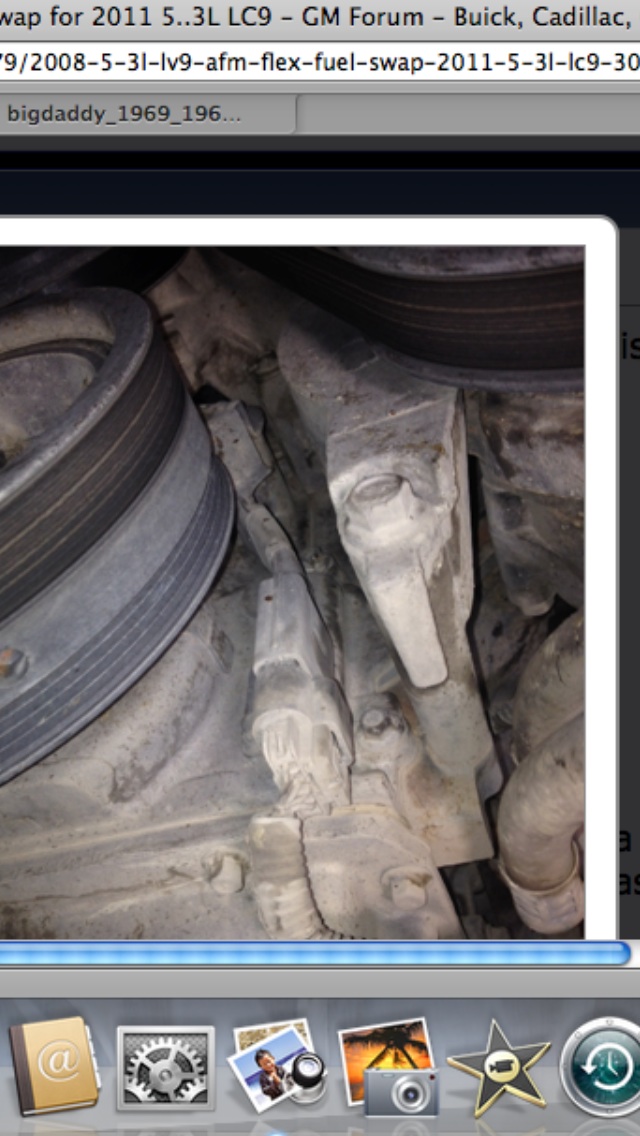

This is the second plug im talkin bout thats foumd on passenger side
Of timing cover ...08-09 dont have it

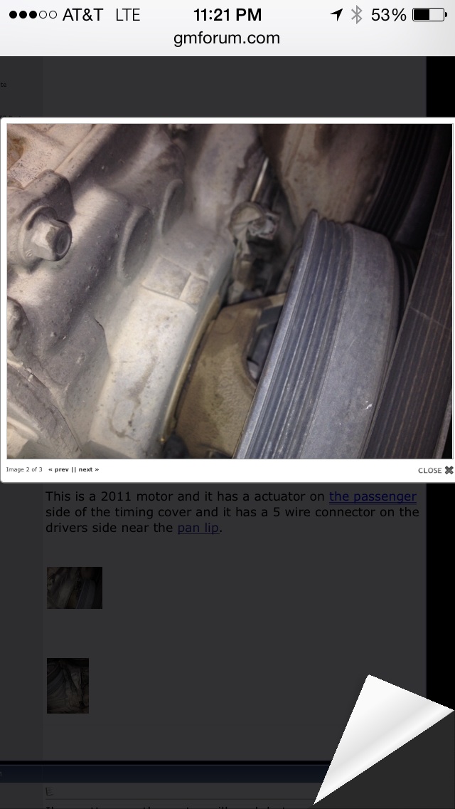

This is the 5 wire plug
