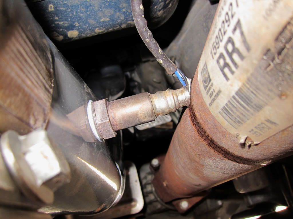

I just installed the new designed Pacesetters and the overall fit is good but have an issue with the O2 sensors hitting. They say they are 4X4 compatible but the driver sensor rests on on the front driveshaft and vibrate/rattle and the passenger will bump the cab bottom when you get on it.
Anyone else with a 4X4 install these and have this issue? Additionally, anyone know if a company makes an O2 sensor that the metal part (heating element) is shorter than stock?

best option is to put plugs in the existing holes and weld in new bungs in the correct place.

I plugged the hole on the drivers side one and welded a new one in. The passenger side just hits the cab. No noise, no change.

Heres what it looks like...
