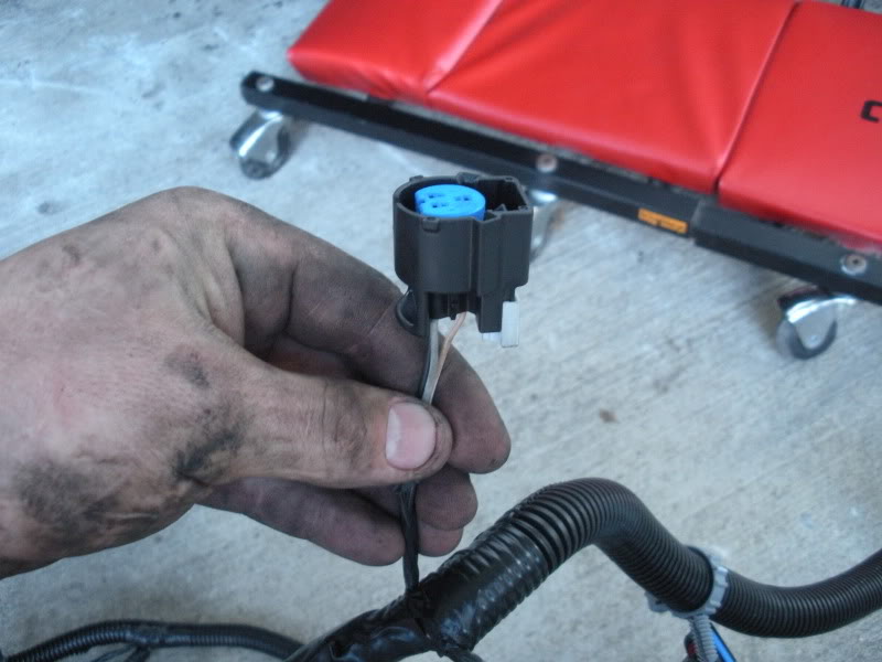

thats the 12v for the relay on the starter. it use to have a "plug"
i put an eye on it since the starter i have has 2 posts.
the oil sensor is the 3 port thats a light blue then i swapped to the 3 port oil sensor my sensor uses.

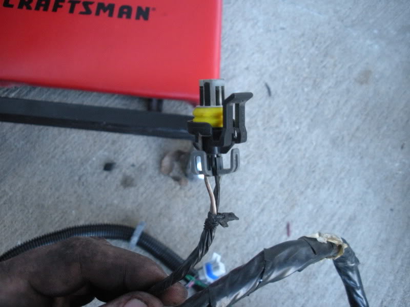

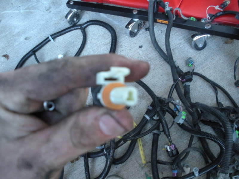

this is the oil sensor on the 09 5.3/6spd harness
this is the stock one thats on my 08 harness i just swapped them over
