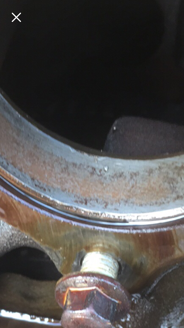

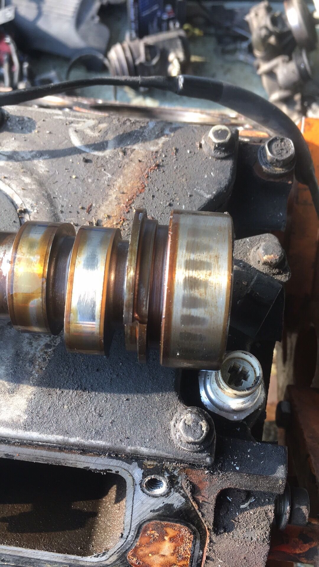

was told this motor had good oil pressure and ran fine out of 02 silverado 120k.I think these cam bearings are bad but thought I'd get some opinions before I waste money on it

Originally Posted by FFDP
If you look at cam bearings they are bad but if you don't they are just fine....
that's what I heard but this pattern on this stock cam was weird

Old Apr 3, 2018 | 03:50 PM
About20ninj45's Avatar
Joined: Nov 2015
Posts: 536
Likes: 7
Replace them before they become a problem later on down the road. I cant see up close but it does look like there is material missing from the bearing. Are you going to be reusing that cam? I would replace that as well
Old Apr 5, 2018 | 08:06 PM
Shtbox's Avatar
Joined: Aug 2013
Posts: 211
Well **** at 120k supposedly I was just gonna stick a cam in it and let it ride.after seeing this tho it's not even worth fixing it after all the parts gaskets and machine work involved just for a 5.3.Im missing a lot of truck nights and bracket races just wanted to cam it step up my stall to a 4200 and run it but no just gonna sell it on Craigslist to someone who wants to build a 5.3.
